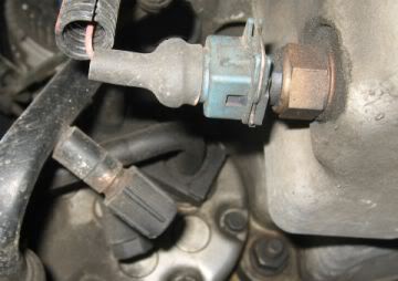

Sorry for the wrong information. If there is a temp. sensor then the connected plug should look like this:
Posts: 55066
x 8391
VertVega wrote:Sorry for the wrong information. If there is a temp. sensor then the connected plug should look like this:
No worries VertVega :D
That's a perfect picture of it. Thanks for posting that one up, better than my attempts to describe it!

Thanks for the info, in your pic does the temp sensor have the 2 wires like my dangling one?

In mine temp sensor has a pink colored single wire and the connector is blue.

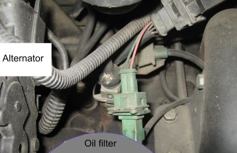

This was the only double wired GREEN connector I have found in that area. It is connected to another green connector. No idea from which sensor/device it is.
Posts: 55066
x 8391
VertVega wrote: It is connected to another green connector. No idea from which sensor/device it is.
I believe that will be the knock sensor VertVega. Certainly on a Turbo CT the knock sensor is on a green connector.

Thanks citrojim, In this recent picture above there is a gray connector seen at the background. Could that be the pressure sensor?
(Above gray is MAP sensor's)
Posts: 55066
x 8391
VertVega wrote:In this recent picture above there is a gray connector seen at the background. Could that be the pressure sensor?
Yes, that's the oil pressure sensor/sender..
