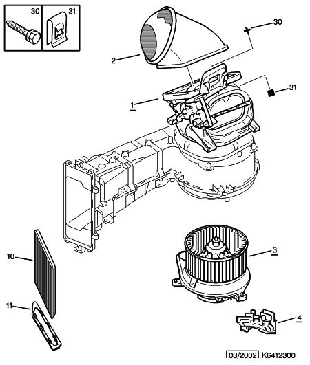

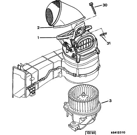

Left picture is from my VIN with air conditioning; right is from Mk I without aircon, where item 5 are the fan speed control resistors as used in non-aircon cars.
Best of luck with that, because it’s as clear as mud. :?
Image Image

My non-aircon '93 Mk1 is showing up as having a pollen filter on the Citroen service site.
I'll have a look in the footwell tomorrow to verify. If I get a chance.. 8)

My recollection is that the pollen filter mounts in the housing that contains th A/C evaporator, and on non A/C cars, the duct that replaces this housing is not big enough to house a filter. The lack of a pollen filter was the main reason I got rid of my first (non A/C) Xantia.

Thanks to Ross_K for posting this picture that I couldn’t get because it said ‘error on page’.
Ross’s picture shows the electronically controlled blower with the transistor drive.
The pollen filter does slide in front of the evaporator.
Hope to have added to the confusion. :twisted:
Image Image
