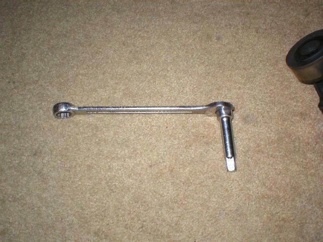

Here is the retraction tool:
It was made from a socket set short extension with two flats ground to enable a 15mm spanner to fit on the end. It was also necessary to grind about 2mm off its length to give room to get it into the tensioner.

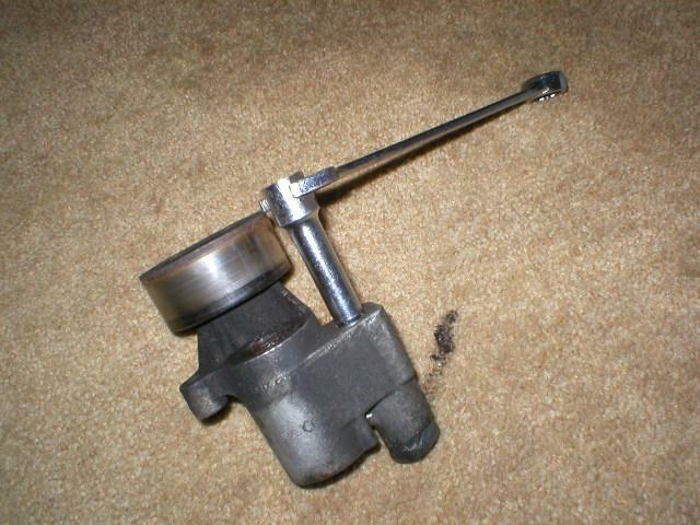

Here is the tool in use. Engine and other impediments removed for clarity.

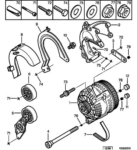

It's a different setup on the XU10J4 engine Adam. Like this:
It's item 5 in the picture.
In fact similar to the one used on the Activa TCT engine. These seem to live a lot longer but the same checks still apply. If it has a nice smooth spring action and the jockey wheel bearing runs smoothly, no worries.
