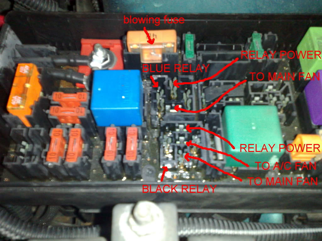

I have swapped the blue relay and tested for shorts and cant find anything. the fans run full tilt as soon as the fuse blowes does anyone know what readings i should be gettin or what the symptoms of a failed bitron unit are

Unread post by theasylum »

Don’t know about that fuse box.
I expected the fan relays to be between the fans, as in the picture … does your car have that ?
The Bitron looks like it’s working normally because you do have two speeds.
Never known of Bitron faults, but they would show up as loss of fan operation or erratic speed changes.
