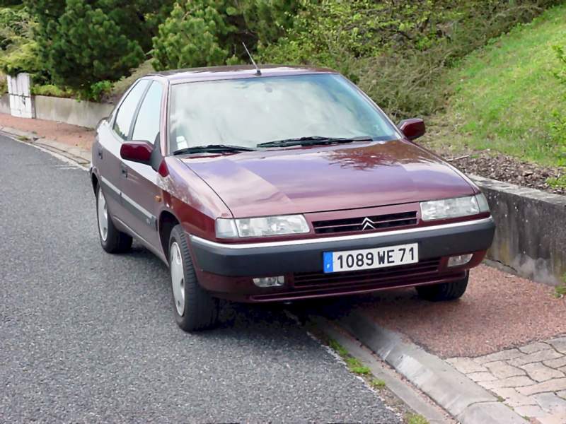

Hi Mr Matthews!
Welcome to the forum!

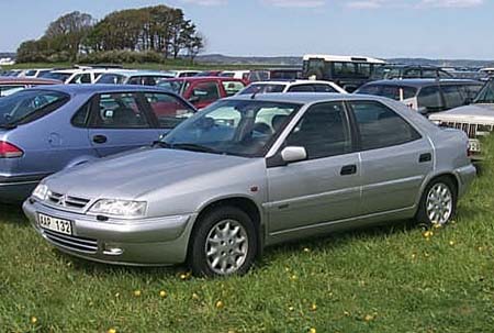

I thought I'd better ask this as the Mk1 was sold well into 1998 so does the front of your car look like this, which is the Series 1 (Notice the straight edges of the bonnet and lights)
or like this, which is the Series 2 (notice that the front of the bonnet curls down between the lights)

[quote="red_dwarfers"]Hi Mr Matthews!
quote]
Thank you red_dwarfers, nice to see somewhere that is buzzing with citroen fanatics, My citroen is like the front of the first picture but its an estate called 'temptation II', being r- reg, I would say the first half of 1998 (I think s-reg was the later '98 year).

No worries Mr Matthews we're all here to help
Yours being the Series 1 will probably have the common blower problems, just unlucky that it happened at the same time as the wiper!
Take a look at the 'Sticky' regarding the blower motor and see what you make of it!
