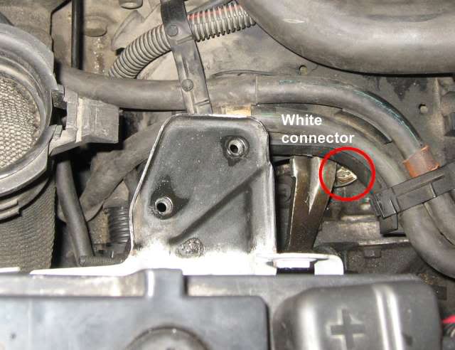

Hi, Xantia II Break, reversing lights are not working. I made a quick search from the forum topics and checked the subject from Haynes :? .
- Should I check the white connector or the wires in the hatch outlet? Which one is more common?
- Is there another cause of this problem?
- How should I check the "white connector" on the gear box?

Most common problem is the hatch/rear door cables.
The gearbox reversing switch is a dead simple make-switch activated by the gear lever. One side of the switch is ignition key switched and fused +12V power, the other side is the reversing lamps.
If you bridge the switch, and have ignition on, the reversing lamps should be lit, no matter the gear lever position.

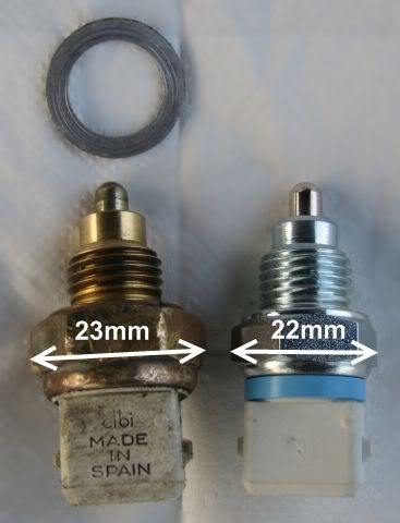

Thank you AndersDK for your instructions :!: The reversing lights are working now \:D/ The switch was out of order.
Here are both switches side by side:
From the package I know that the new switch is also made in Spain (another 10 years) :D
The most difficult part of the replacement job was removing that plastic cover over the gear box. Also there is not so much free space around the switch.
