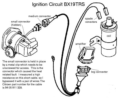

I once had a very strange heat related ignition problem which took me years to isolate. Sometimes after shopping for about half an hour the car would refuse to start no matter how long I turned the engine over even with the pedal pressed to the floor as recommended by Citroen for warm starting. The strange thing is if I opened the bonnet and sat in the car for about 3 minutes then it would start on the button, every time. I eventually traced the problem to poor connectivity in the small connector on the distributor which carries the signal from the magnetic sensor to the amplifier. I measured a high resistance of about 10 Ohms on this short cable, so I bypassed it with a pair of wires.
At one time or another I have solved ignition problems by cleaning and reseating the various low voltage connectors in the ignition circuit. The spade connectors on the coil seem to be especially troublesome. I also once traced a missing spark problem to poor connectivity on the big connector to the amplifier which I cured by spraying the contacts with WD40 and reseating a few times. I have also more than once traced a rough idling pattern and cutting out to poor low voltage ignition connectivity. Somebody on the BX forum also recently traced lack of power problems to a poor spade connection on the coil.
So the moral is, before you go throwing money at the problem, just clean and reseat all the connectors shown on the illustration below. Also, if you have a resistance meter, check for good continuity in the signal path from the distributor to the amplifier.
