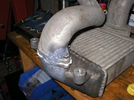

I once did an exceedingly successful repair using Chemical Metal on my son's Nissan 200SX Intercooler.
The elbow joint flange had snapped. Still good to this day.
