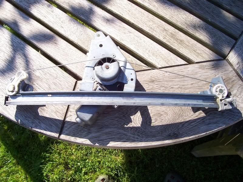

Here's a picture of the whole assembly - bear in mind it's the passenger side so everything is reversed.

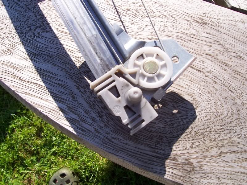

And here's a photo of the plastic block. You'll see that this one is cracked too, but that's because I dropped it! Again, bear in mind it's reversed.
As I said, I drilled (1 or 1.5mm drill) some carefully placed holes, wired it up with SS locking wire, and potted it all up with epoxy. I thought I'd taken a photo of it after I'd done it, but I can't find it now!
