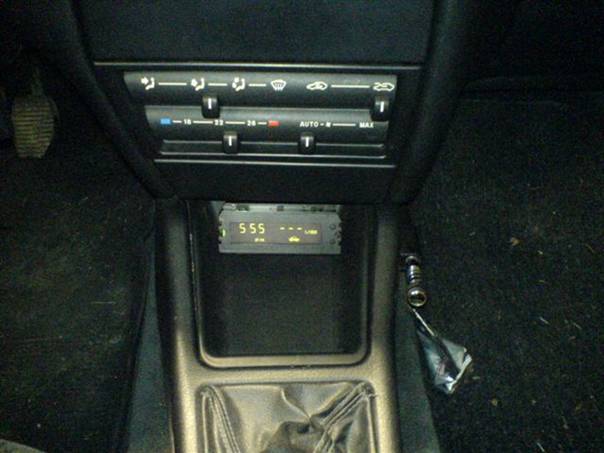

Yep, have seen this on a czech xantia forum. They are using the old board computer from the XM in HDis.
Looks like this:

Looks like this:
