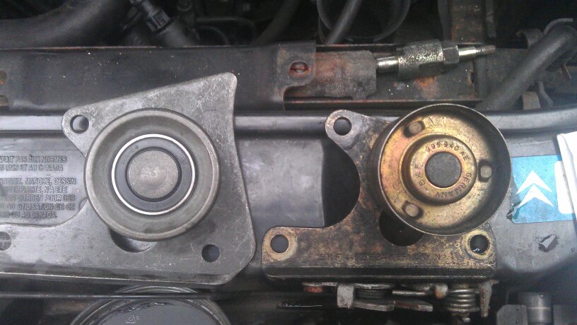

More strange cambelt findings with Jenny...
As you can see the old one has a smaller backplate than the new one.
Sent from my HTC Sensation 4G with Beats Audio using Tapatalk 2

A productive afternoon, cam jockey replaced, aux belt auto tensioner fitted, water pump fitted (the old one didn't have the metal shield!) and new anti-freeze added, 19mm O-rings in the hydraulic pump replaced.
