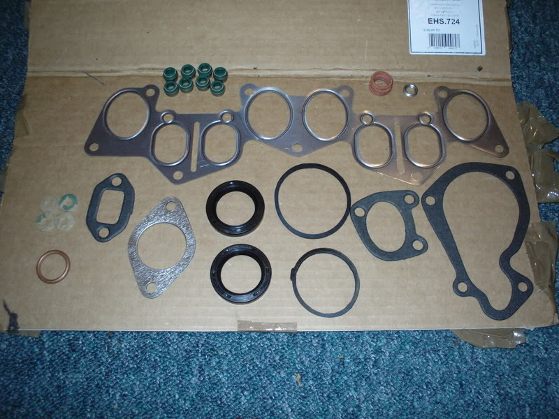

Can anyone identify what these parts are for? Presumably it will be more clear on rebuild (removal is a distant memory ) but it's better to familiarise myself beforehand I think.
Starting at the top, I know the 8x green seals (left) are for the valve stems. The copper and tin washers (right) are for the injectors and of course, the big eight-hole tin plate is the manifold gasket but I'm unsure about the rest at the bottom.
Far left is 4x thick, card washers and one big copper o-ring below?
Next to those is a sort of foam-type gasket that I suspect seals the water pipe cover behind the fuel pump?
Next to that looks like a small exhaust downpipe gasket?
The 2x thick black seals look identical and I assume one is for the camshaft but the other?
Then there are what looks like 2x small drive belts?
And finally, another two foam gaskets? The odd shape should be a big clue but doesn't ring any bells.

Hi Mike,
This is a universal set and some you might not need...
Along the bottom, the little round ones are for the rocker box cover studs (I think)
Then, left to right, water plate behind the pump, ?, camshaft - the second one being for cars that don't have a vacuum pump on the end but a pulley. Only one needed in your case, Thermostat seals, the next two are for the thermostat housing.
I have no clue as to the function of the copper ring or the big silver oval gasket. I will play a blinder and say EGR valve.
You seem to be missing a big thinn and very small thick O ring set for the vacuum pump although the old ones are usually reusable.
