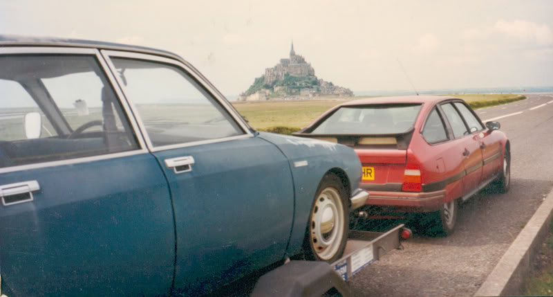

Unread post by andmcit »
But you've got it on the wrong way round!? :wink:
Those Cx mirrors get about the place too, don't they!
And still around in '98... :shock:
Nantes to Swansea, South Wales;
Yes, for a one owner 1972 GS 1222!!
Andrew

Posts: 28565
x 5614
That's a nice looking town cleverly framed between the two cars.
Toby_HDi
Posts: 1354
Joined: 05 Jan 2008, 21:31
x 3
Unread post by Toby_HDi »
myglaren wrote:That's a nice looking town cleverly framed between the two cars.
Mont. St. Michael I believe
