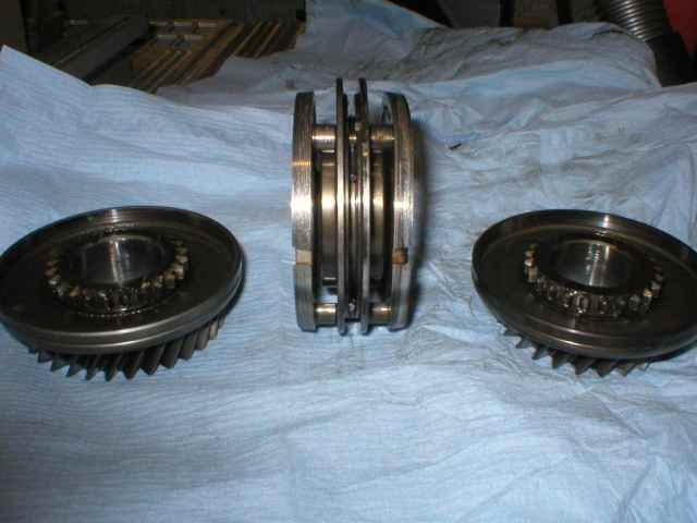

It's not hard to strip the 'box so far as to expose the gear clusters and synchro hubs and no special tools are needed, just beware of the detents on the 5th gear slector fork and the selector rods. Springs and balls can fly!
The synchro hubs can be reasonably inspected then to see if they're worn.
Here is a worn one:
You can just see the tapered faces of the light alloy cone clutch are shiny and a bit distorted. A good one will be dull and have radial lines on the faces. Also, you may also see the effets of intense heat on the steel parts of the clutch in the form of "blueing" on a well worn one. Another often seen problem is the breakage of the spring in the middle of the alloy cone. Another test is how far into the stell part the alloy cone will go. I should stay just a little proud. If it drops right in and the edge disappears it's well worn and will not exert any frictional force against the steel part.
All BE3 'boxes use exactly the same cones so any will act as a spares donor. generally all 1.9TDs used similar ratios and any minor differences can be lived with for the sake of a decent gearchange.
I'll try to take a picture of a good hub for comparison. I have one knocking around here somewhere.
Here is a worn one:
