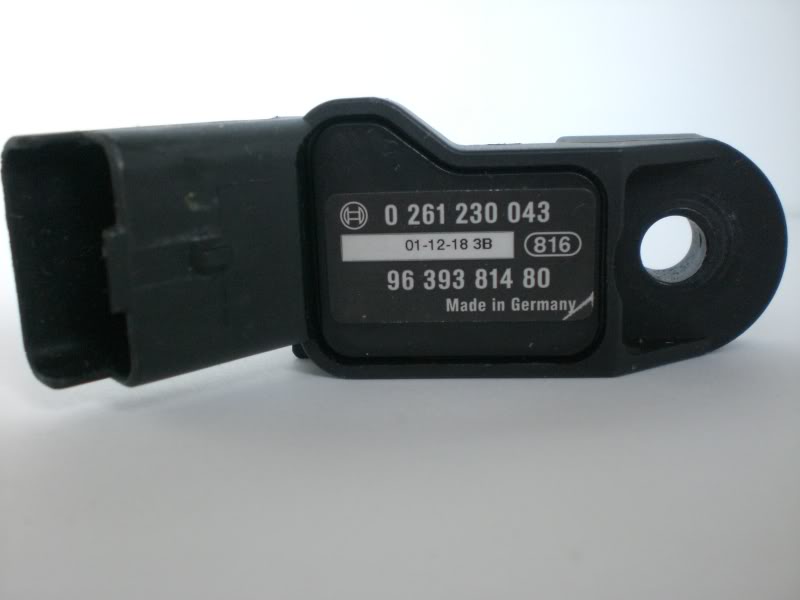

From reading this and other forums I also suspect the MAP sensor - on this vehicle its on the drivers side end of the inlet manifold. The Bosch part number on this is 0 261 230 034, but one ive found on ebay which states it fits this vehicle has part number 0 261 230 043. These both have a black sticker with the part numbers.
There is also a MAP sensor on ebay with a blue sticker which is part number 0 261 230 057 and states it is the same as part number 0 261 230 034 which is my one. So which one of these is the correct one?? I believe one may be 3 pin and the other 4 pin.

Im pretty sure its a map sensor - it looks like this:
