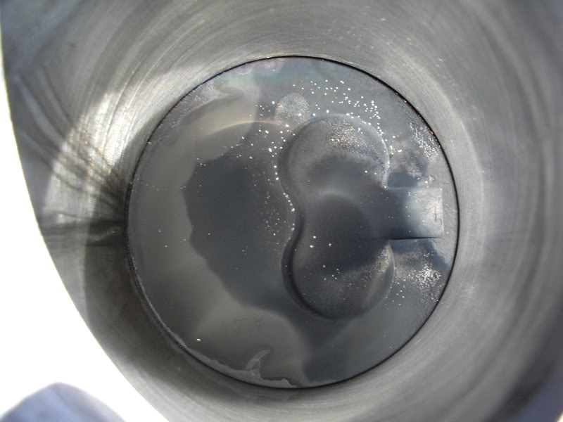

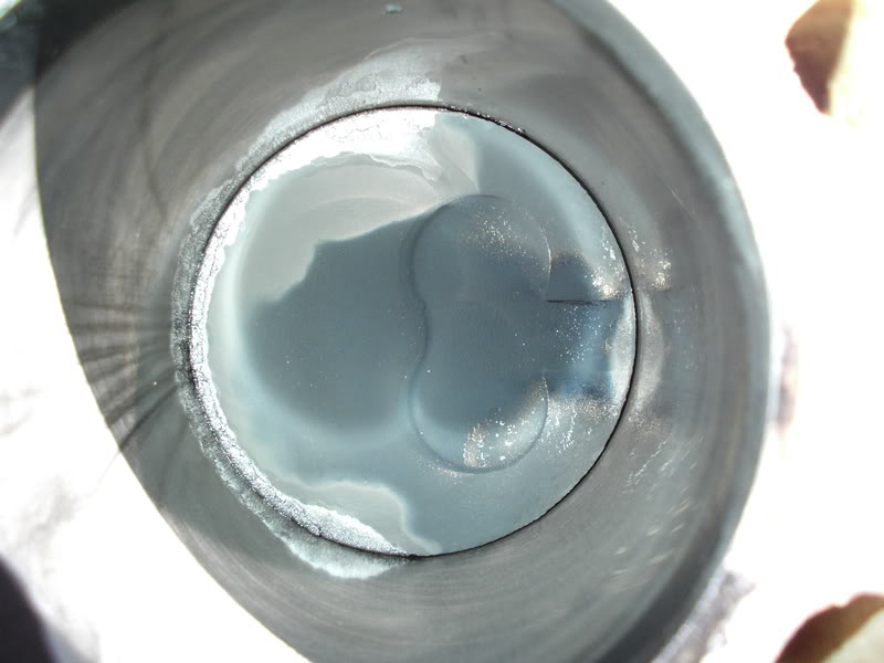

Trouble is Jim, I have a very inquisitive mind and would like to understand what I'm seeing.
These are the two centre bores, pistons at BTDC. What I was hoping to capture was the criss-cross honing marks and the white speckling on the crown. And what's with the vertical streaks and broken carbon on the rear side of the walls?

That doesn't look good to me.
Cassy's were practically spotless (apart from the slight valve impressions - will see if I can find the photos tonight), but then her HG hadn't gone, although saying that, her old head had been skimmed once before by the looks of it after we removed it.

that valve in the bottom picy looks like it might be bunt/burnning out, both picys look like there is something elss wrong, it is very important to have the head presure tested especialy as you cant see an obviouse gasket faliure, i susspect you are far to far away from ST LEONARDS ON SEA as i biult my own XUD presure tetting rig, down here if i had to go to get a presure test done it would cost around 40 squide

I agree Malcolm and Xac, it does not look good in the pictures.
The white looks very much like coolant corrosion and doubtless the time spent as a "work in progress" has not helped
Don't dispair Mike, give it a clean up and see how it looks then.

Are those pictures of valves? - they look like pistons at the bottom of their bores to me - and the strange feint lines are reflections in the bores.
Still strange looking whiteish deposit to the left of the lower one looks like water corrosion to me.
Have a good look at the head for cracking - although this seems to be a BX problem and better design or metal eliminated this from Xantias.
I'd run a straight edge over the head face and see if I could see anything like indentations. I appreciate that with some gaskets its virtually impossible to get the head face clean enough to make this worthwhile (I've used oilstones in the past when I didn't want a skim taken.)

Mike,
Those streaks on the back of the bore intrigue me. Were you by any change running it on a high ratio of veg just before it was laid-up to do the head? And did you just start it up briefly to say, move it into position and did not run it long enough to get it hot?
If the answer to both questions is yes then maybe these streaks are nothing more than veg oil that has been injected and shot out of the prechamber and across to the back of the combustion chamber and has not been burned in the combustion chamber. I say this as if you look at the pictures of the head in your blog thread, you can see a corresponing dark mark from the prechamber of one cylinder across to the back.
A good deal of cold veg does not burn and remains a liquid in a cold engine and is the cause of polymerisation in a DI engine when it shoots out, remains unburned, slides down the bore, past the rings and ends up a gooey mess in the sump and gums up rings.
It's only a bit of speculation but it may explain those streaks. The head also suggests to me that it did not get at all hot the last time it ran on account of the black, fluffy soot present.

Thank you everyone for your comments and I apologise for the error - I meant the pistons are at bottom dead centre so yes, you are seeing the bores, and pistons at the bottom.
It's too late (gone midnight) to go into all of this right now so I'll just ask if those (combustion?) marks could be the work of easystart? It could be that each line represents each dose as I know the AA used it once and I may have done two or three before I fitted new glow plugs

The marks on the bores - and the piston corrosion (second photo) concern me. If it were my engine I'd pull the pistons out to inspect the rings - as if they are in good order I can't see how the marks on the bores could stay there. Others may have better theories - but as they say 'I've never seen anything like it in my life'
I think the corroded left side of the piston in the second photo is evidence of water getting into the combustion chamber as indeed are the relatively clean pistons.
Broken rings could have contributed to starting problems - causing you to use easystart. I thought (not having considered the maatter in great detail) thet the problem would be the very loud knocking caused by 'Overfuelling' - which you can get with a poor starting diesel when it fails to ignite first time and when it does fire there is more than one charge in the cylinder - hence a very heavy explosion. In the case of easystart there would be a charge of fuel and a dose of ether which could cause a very large explosion.
