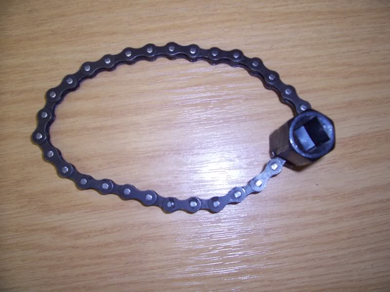

Replaced the rear suspension spheres last night, no issues, suspension now works great. Last time I replaced the spheres on my BX must have been 20 years ago, so it was a case of re-learning. Suspension on high, axle stands in, crack the spheres, release the pressure, & remove. I used a Halfords chain wrench (pictured) which did the job admirably.
It has a half inch drive, and with a 12 inch extension you can use a big breaker bar just behind the rear wheel - gives you plenty of room.
