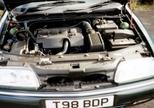

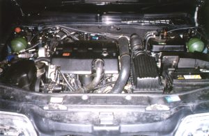

The other way to tell is by looking for the intercooler pipe as seen on the second Xantia here.
Richard
