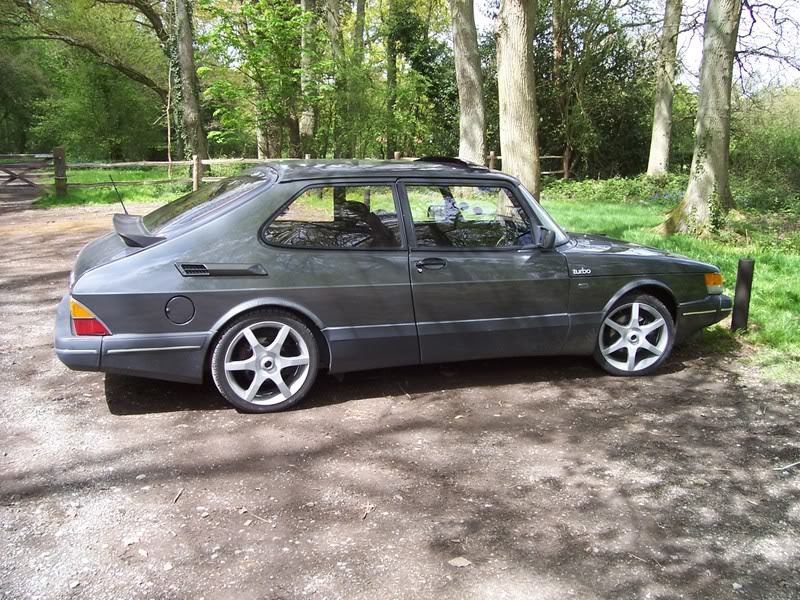

Here's my toy - a few similarities with yours, but your one's shinier!
Need to refurb my wheels too, got them cheap off ebay - not in the best condition.
Haven't driven it for a few weeks, just torqued the head down yesterday after HG change.

Yep, both old school and turbocharged, is that a 16 valver?

Yep, 16 valves, made 196hp on the rollers a few months ago with just a tweaked APC (Saab's electronic boost controller).

ianrobbo wrote:Yep, 16 valves, made 196hp on the rollers a few months ago with just a tweaked APC (Saab's electronic boost controller).
Might take you up on the wheel refurb thing - maybe PM you middle of September when you've got your feet under the table?
Ian
Sure no problem, where in the country are you? I'll be in Kent/Surrey area. I assume 196 was @ the flywheel? What boost was that?

Just looked at the figures, max boost was 13.6 @ 3500 rpm. I've done a couple more mods to the APC since then, reckon it'll be a little bit more by now.

How do you adjust the APC? Do you ever get boost spikes? I have to compromise with mine because of the bigger turbo and lack of space, the actuator has very little room to actuate at a good angle, got boost sitting at 11psi peak and then dropping off a bit to around 10psi off the standard -31 actuator, which is a 7psi spring.
I'm going to fit an MBC back onto it now i've played with the angles, the activa has the old valve off it, cant wait to get it running 16-17psi again but i always had problems with it creeping top end, i suspect because the actuator arm was too short and prevented the actuator opening fully. Now i've resolved this issue my EGT's should be a bit lower aswell!

The APC is basically a knock controlled electronic boost controller - the knock sensor backs off the boost when it detects knock, allowing Saab to use quite a high comp ratio and also enable the use of lower octane and/or poorer quality petrol. There are two ways to tweak it - there are 3 variable resistors inside, one for max boost, one for boost rise rate, and one for knock sensitivity. You can simply turn up the max boost pot - simple as that. That's the easiest way to tweak it, there's also a well documented mod out on the net, where you change a couple of resistors on the pcb, which helps with max boost and also holding the boost at high revs. Dead easy.
Many of the Classic 900 owners also fit front mounted intercoolers and 3" exhausts, 220bhp is quite easily do-able for not too much money, but the gearbox is a bit on the fragile side so you don't see many outrageous ones. Can't say the same for the 9000 guys though - some of those guys really go to town, as much as 500hp! Crazy talk for a fwd! www.uksaabs.co.uk and www.saabcentral.com are the two main UK based ones (although Saab Central is very popular on the other side of the pond, and in Oz) and www.900aero.com specifically for the 900.
