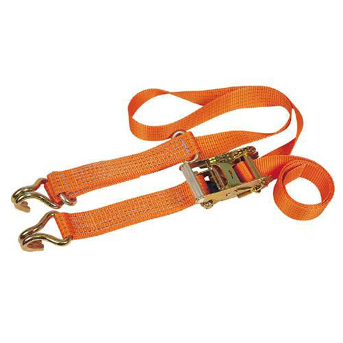

The other factor to consider to prevent calamities is to VERY FIRMLY
secure the towed car and I've found over the years that you really can't
beat these from places like Machine Mart:
http://www.machinemart.co.uk/shop/produ ... er-lashing
for a great as well as fast solution - makes the process far easier.
