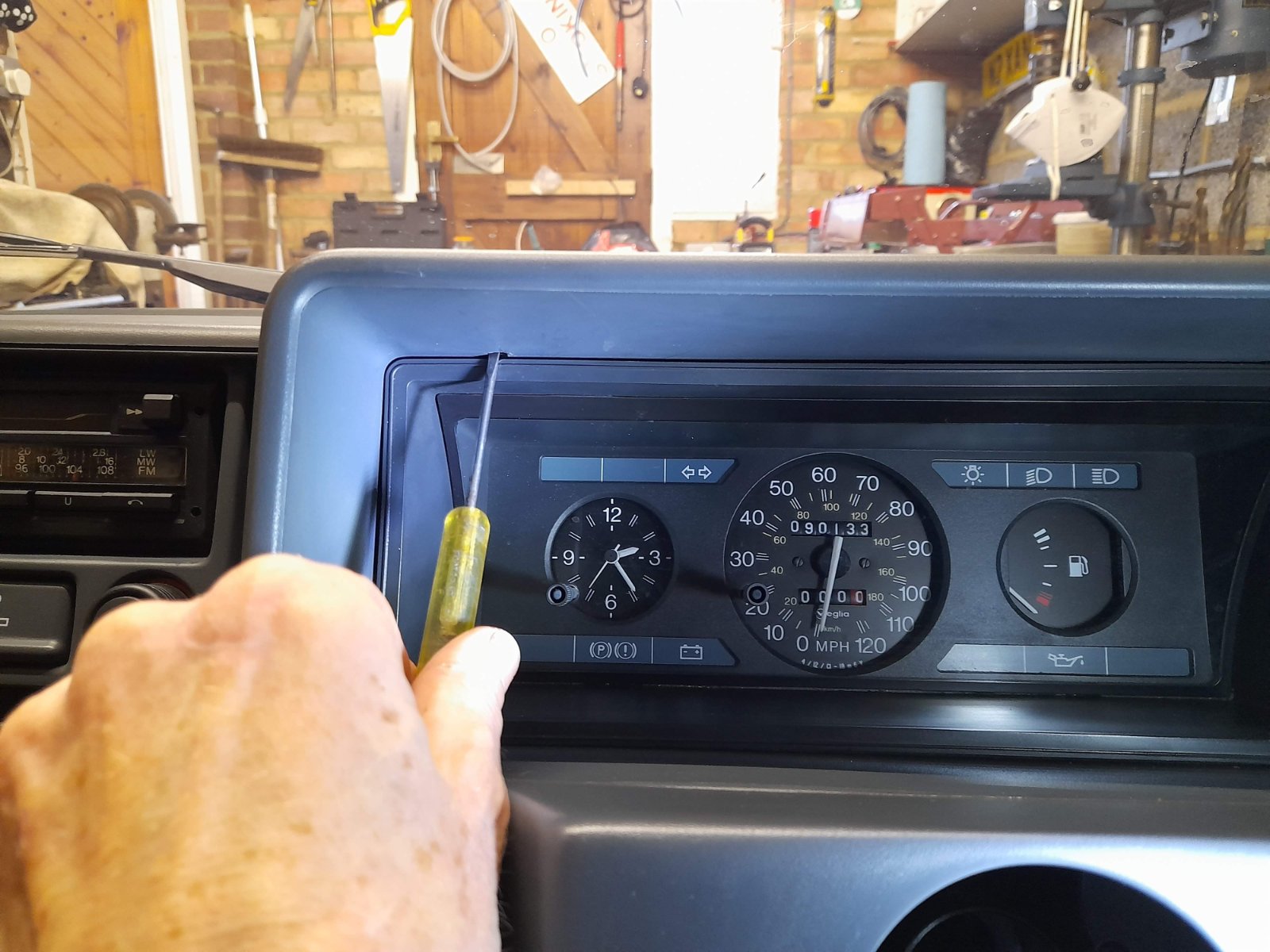

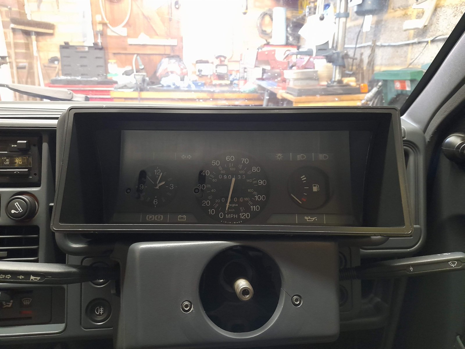

When you know how to release the clips, removing the instrument pod from an S1 AX is a piece of cake :D On the S2 AX and Saxo this is a horrible job in the extreme... I feared it was going to be just as horrible on the S1 but just the opposite - result!
All it takes is a PO No.1 screwdriver and a bit of gentle pushing from behind...
And in coming out the speedo cable automatically unclips :)

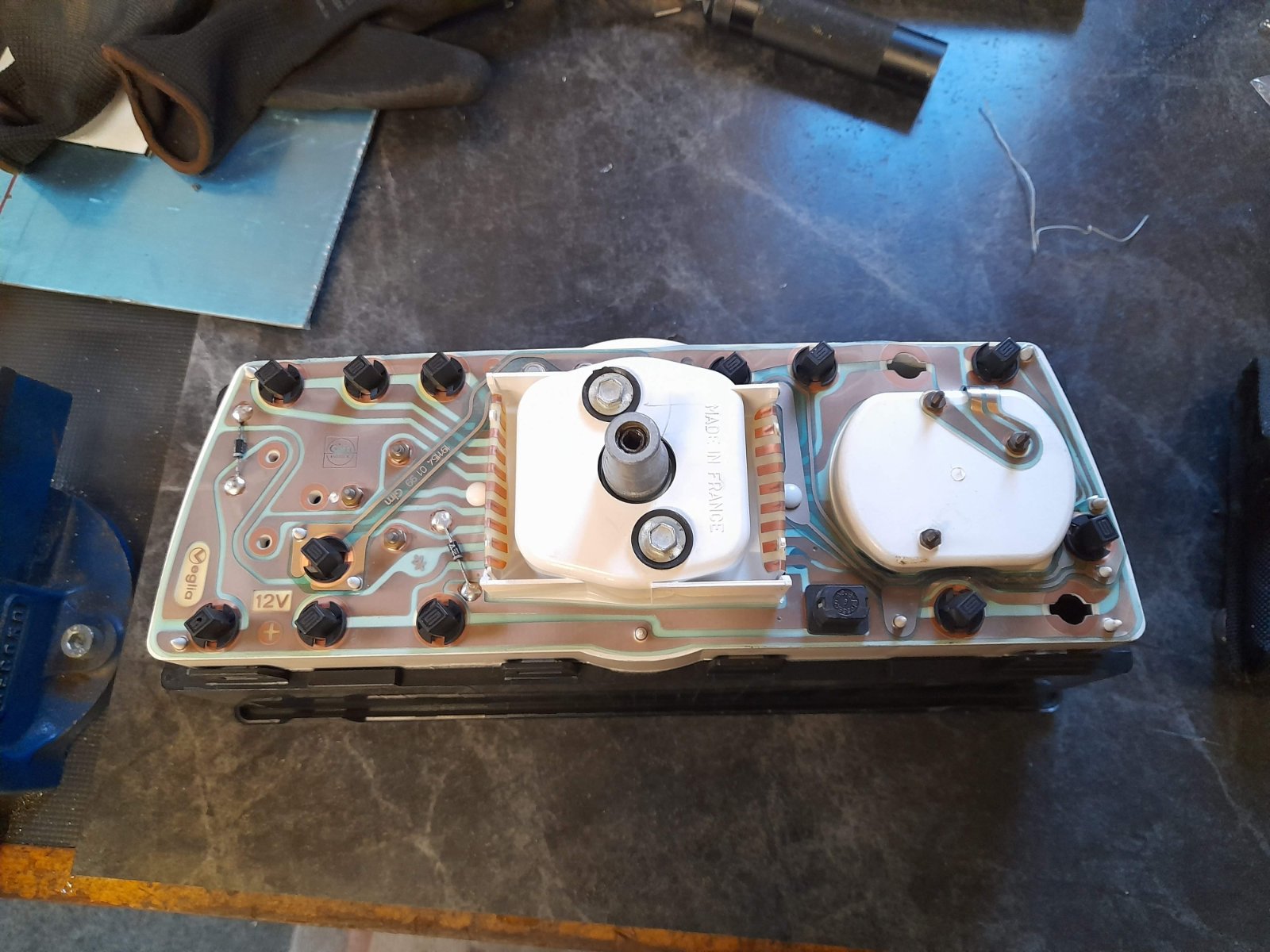

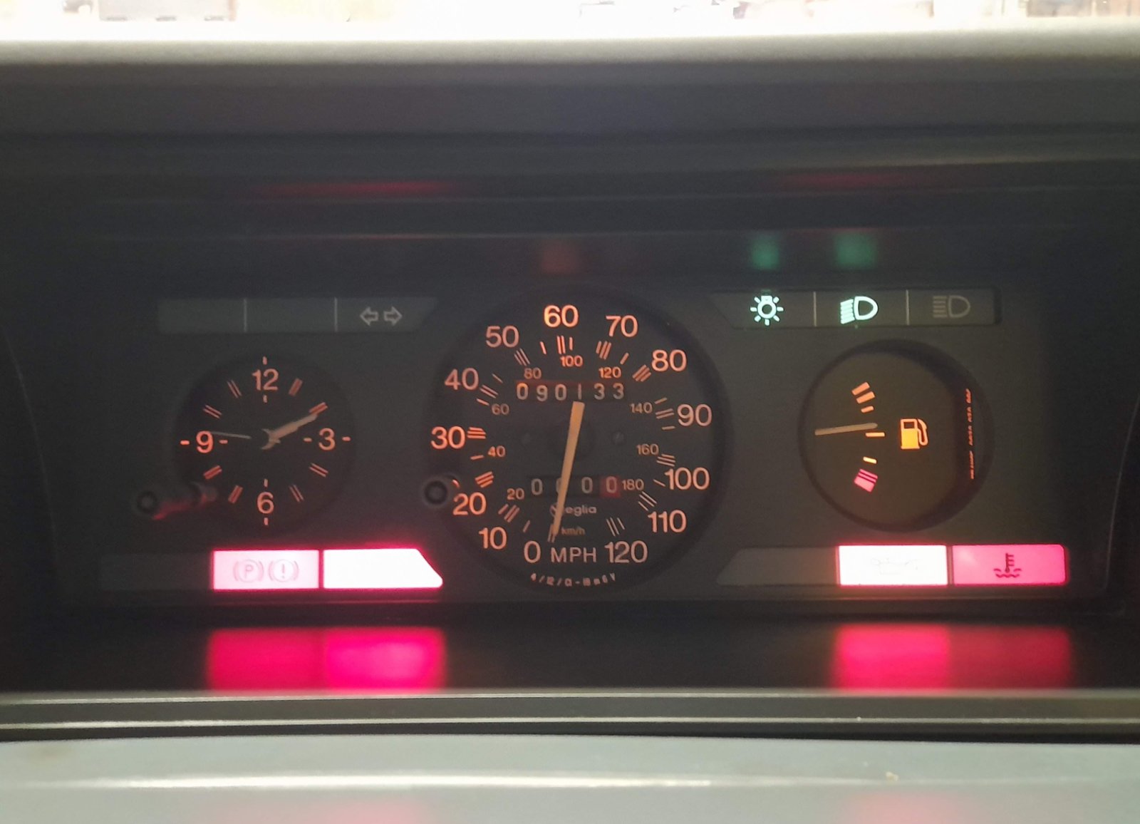

Bulbs all checked and replaced where needed...
That's as good as it gets... With only three bulbs it's never going to be very even and spectacular but at least it's all readable at night now :)

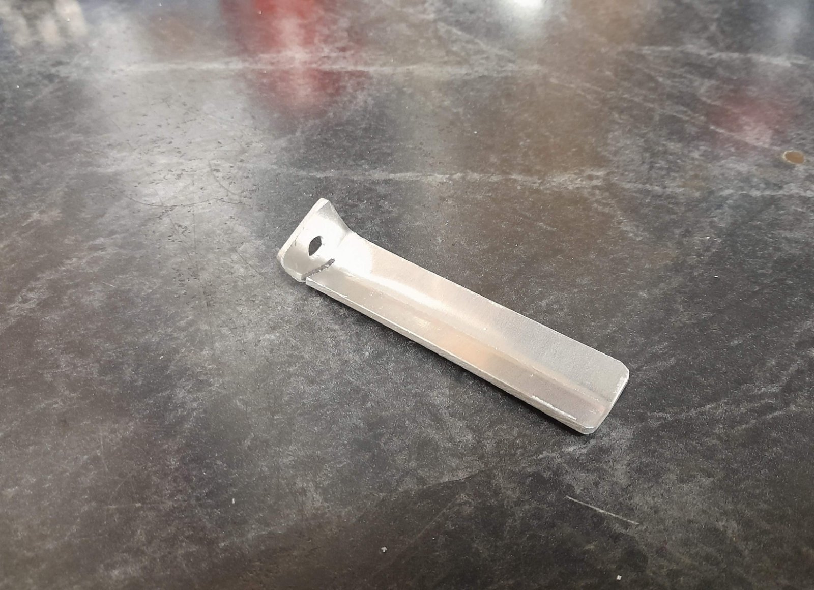

One last little job on Bluebell today...
A new, improved design dashboard support bracket for the passenger side... This supplements the broken/cracked/weak plastic boss that allows a long bolt to attach the dash moulding to the A pillar... All S1 AX dashes break here and Bluebell is no exception...
I'll be making a new one in this style for the driver's side tomorrow...

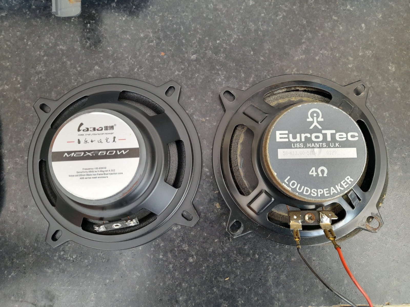

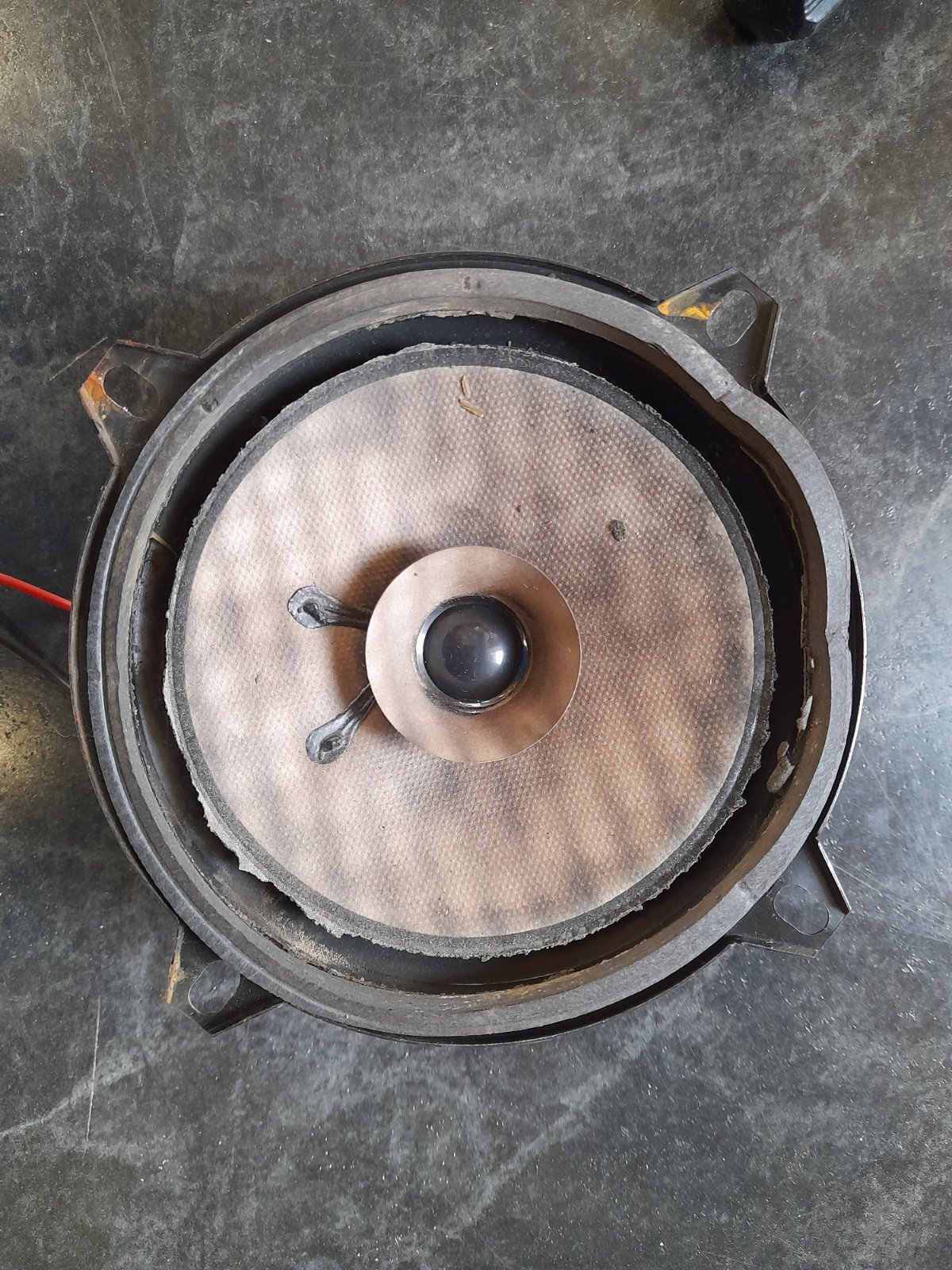

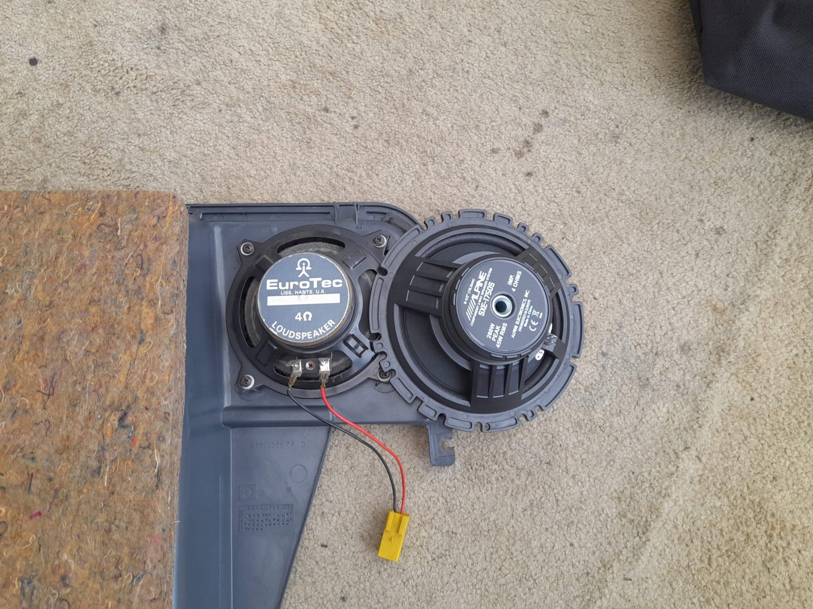

I had a look at the radio speakers... I guessed they were the cause of the heavy distortion and indeed they were!
A good bit of the cone suspension is missing - in fact all of it!
Alasdair and I had already got a pair from a Pug 106 in a scrapyard but sadly...
A bit too big :(
Amazon has now provided...

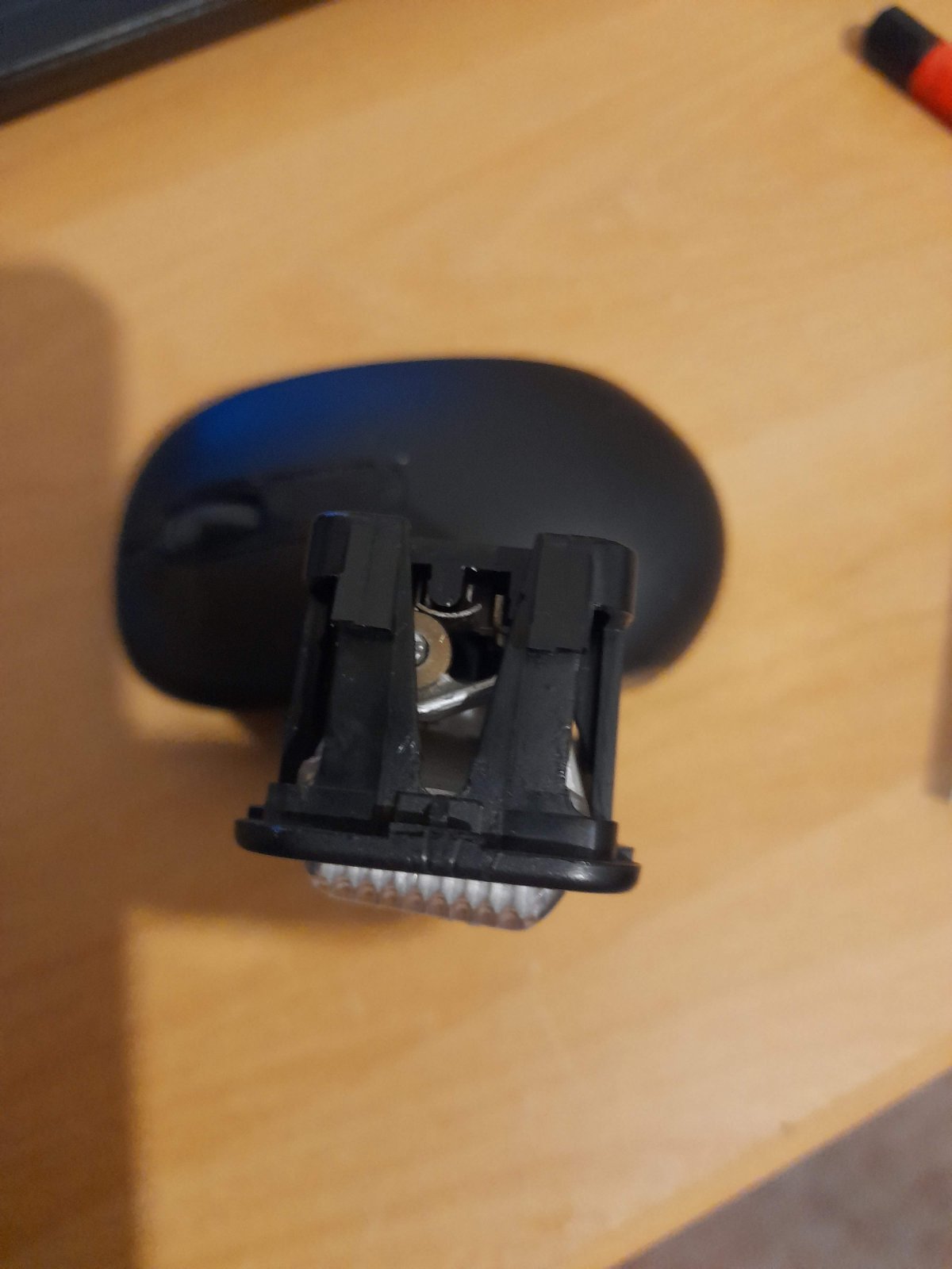

Next up, the interior light... I'd already cleaned the door switches but this did not bring forth illumination...
The cause was very badly tarnished contacts in the light itself, especially the contact roller... Sorted with a fibreglass pencil and a squirt of contact cleaner...
Tested good on the bench but still duff when in the car... That had me properly puzzled until...

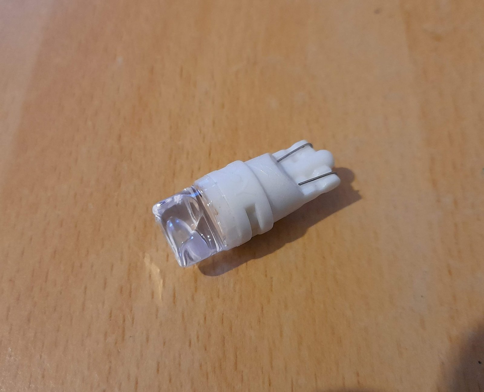

I discovered these Chinese LED bulbs are polarity conscious! Who knew? Explains why I once thought I had a load of duff ones :lol:
I like an LED as an interior light - much, much brighter than the traditional bulb...

LED interior lights: yes, me too, well worth upgrading these. Especially when you can buy 10 from China for almost nothing.

CitroJim wrote: 02 Nov 2022, 17:30 Much of today was taken up with domestic work so just a couple of little things done...
All four speakers in 03 plate Xsara Picasso that inhabits my driveway were in that state when I changed them back in May.

MattBLancs wrote: 02 Nov 2022, 20:14 Especially when you can buy 10 from China for almost nothing.
The source of mine Matt! I bought 15 for pennies and hence, until I found they were polarity-conscious, I thought there were several dead ones in the pack given their cheapness... Happily, they were all good once realisation had dawned :)
Michel wrote: 02 Nov 2022, 20:32 All four speakers in 03 plate Xsara Picasso that inhabits my driveway were in that state when I changed them back in May.
Both of the speakers in my erstwhile white S2 AX were in the same state... I think they may have had rolled foam suspensions at one time and sunlight/time seems to have been the destroyer... You can see shadows of the grille on the remains of the cone where it's been sun-bleached... I saw the same on the S2 AX speakers...

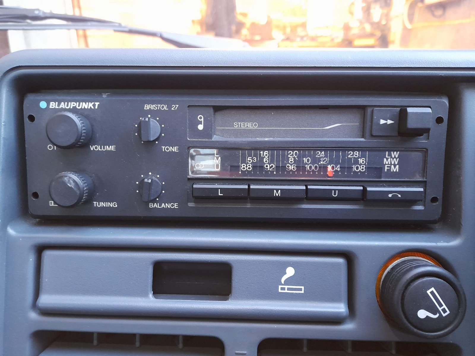

I fitted the new speakers... Remarkably, size, fixing and connection-wise they are identical to the old ones...
They sound good :D
The radio is very good and it's lovely to have a no-nonsense one with a proper tuning scale and no digital silliness to make life over- complicated...
The tape deck isn't working but it soon will ;)

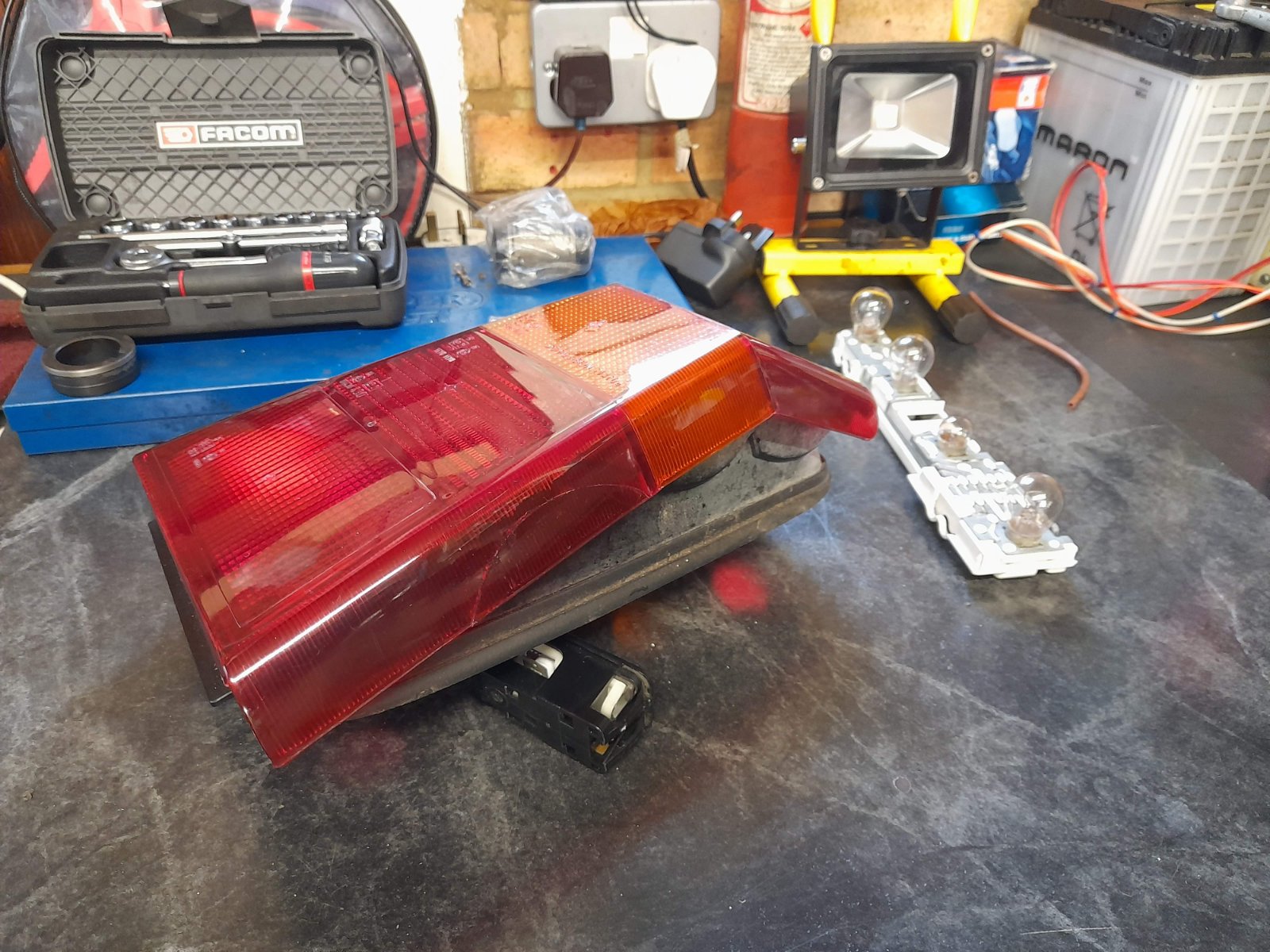

Yesterday I did a repair on one of the rear light clusters... In removing it on the very first day I got the car to replace a blown bulb I clumsily broke a bit out of it... It really annoyed me so I did a repair... Normally I'm rubbish with sticky stuff and whilst it's not perfect it's better than having a bit missing from it ;)

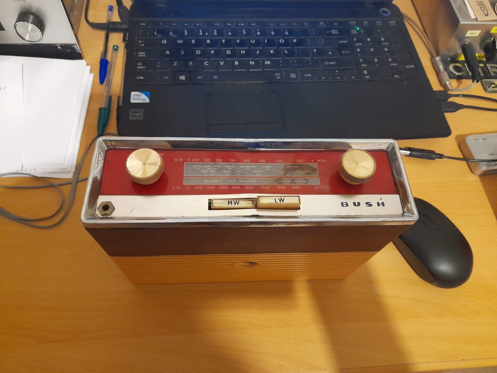

I can go one better than that Bobins ;) I have this old Bush convertible car radio that was designed to slip into a cradle when in use in the car and then be withdrawn and used as normal portable radio outside the car...
Sadly, I don't have the cradle and batteries are a problem these days as it uses the now more or less unobtainable PP7... The radio itself works well..

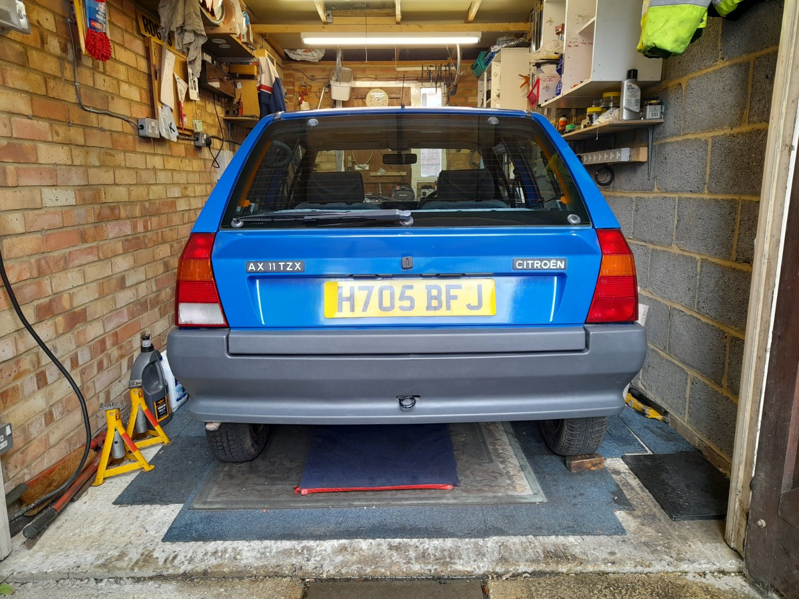

Not much car work today as busy doing other things including preparing for the Salcey Forest Duathlon on Sunday which entailed a nice ride out on my duathlon bike on what's been a gorgeously sunny, albeit chilly, day..
There will be no car work this weekend as tomorrow is the best day of the week - parkrun day :-D
I did manage to find time to apply a bit of bumper snot to the front bumper and the mirror backs.. It's made a heck of a difference 8-)
I must now do Sally's bumpers, side strips and mirrors...

Apologies I have not read the full blog (527 pages, by Eck!) But first image I've seen of the AX that wasn't a close up, "doing a job" image - what a lovely colour that is! Not enough bright coloured cars in the UK, far too much play it safe monochrome shades.
Also like the unusual font of the numberplate too.
