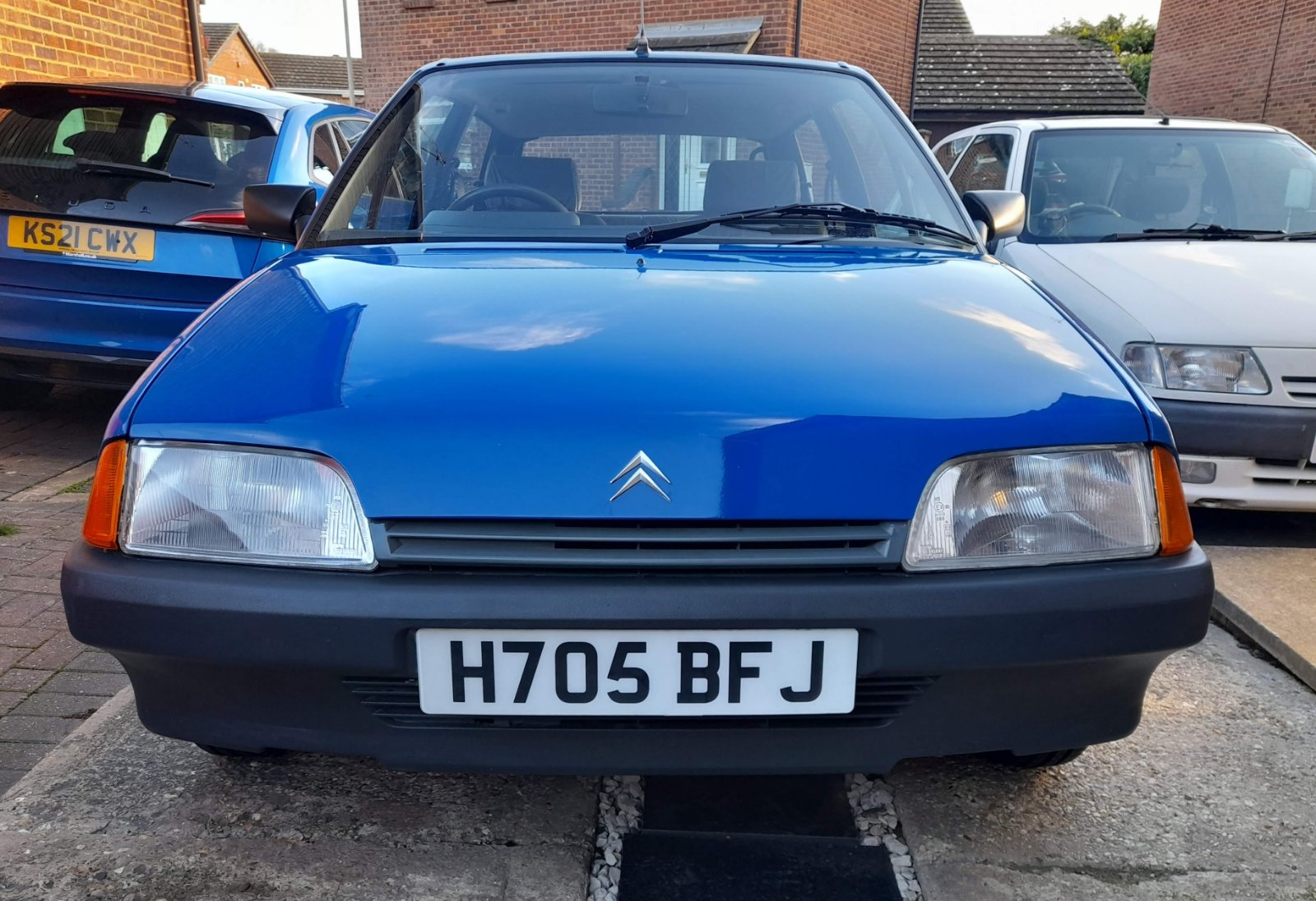

Apologies I have not read the full blog (527 pages, by Eck!) But first image I've seen of the AX that wasn't a close up, "doing a job" image - what a lovely colour that is! Not enough bright coloured cars in the UK, far too much play it safe monochrome shades.
Also like the unusual font of the numberplate too.
