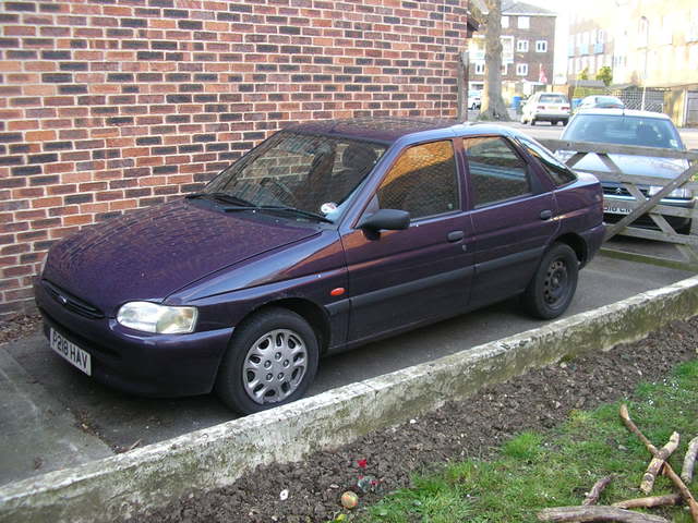

that night my boss sold me the following car and i only include a picture here because it has proved invaluable in my quest ney obsession in getting a Xantia 1.9TD :) so for all those offended by Dangenham Dustbins i apologise in advance and yes Admins i will remove it if requested :lol: :lol:
i only paid £260 for it and the boss let me pay weekly so there are some good ones about (bosses i mean :lol: :lol: ) it was leaking like a sieve at the rear and the heater was not working but they were easily sorted it was the small problem of having 6 weeks MOT and 2 weeks TAX that needed sorting and the small problem of having a second hand Mondeo engine fitted that was worrying me :oops: :oops:
the engine was done by the mechanic at work the boss paid him and i paid the boss weekly total outlay was coming close to £650 now it had a 12 month MOT :( :(

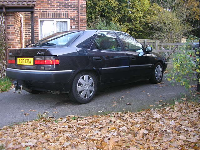

well this is where it all comes together and im not sure if i need the men in white coats to take me away for spending that sort of money on a Dagenham Dustbin 1996 (ok i admit thats good enough reason in itself :) ) or what i did next
i saw this Xantia in my local garage 3 weeks ago and decided i was going to have it :D :D
it has just had a new HG valves water pump cambelt aux belt 4 new tyres and a 12 month MOT and i bought it for £500.yes its a 1.9TD i finally got a working example :) :) but i had a problem i didnt have the £500 so i got my boss to buy the Dustbin back for £500 cash,my only problem was i still owed him £150 for it all in and today is the day when my last installment was made he even let me use it for a week whillst i sorted some minor niggles out with the Xantia ie wouldnt start air in system heater blower not working (mod done thanks Richard W Mandrake and Citrojim :D ) new acc sphere hydraflush heater matrix leaking (Barrs Stop Leak what a wonderful invention :D :D ) dashbulbs replacing and of course the obligatory 6 months Tax :( :(
so i have decided that having owned 5 cars(all Fords or Vauxhalls )in the previous 23 years i have now owned 4 Citroen Xantias in the last 13 months i will stick with the Xantias :D :D
They dont feel so tinny and plasticcy(sp??) as the others and i cant recall seeing one that has been devouered by the tin worm.they feel well put together and despite(or maybe because of)their complexities thay are quite simple to work on for the (very limited) DIYer
But my biggest thanks goes to each and everyone of you all on this forum without whose help i would still be driving a Found On Roadside Dead :D :D :D

No problem with showing a picture of a Ford. A thorn amongst roses :lol:
I jest, I have a lot of time for the old Fix Or Repair Daily. Ive spent plenty of time working on them in the past. My dad and son were ardent fans of the marque until they found Pugs and Nissans respectively.
I had a Fester myself in days long ago, a MKII, back in the days when I was commuting daily to London and my car was spending 95% of its life parked in a railway station carpark, often overnight. An old Fester was just the job. It was still going at 21 years old not so long back after many encounters with a MIG welder.
One thing that has to be said about the Fords of 10 or so years ago, when I lost touch with them, is that you could still do most repairs on them with a bent fork and a spoon as they were so simple and straightforward. It was just a shame the old tin-worm had such a fatal attraction to them and that generally, they are as dull as dishwater. They are like the automotive equivilent of a kitchen appliance. Unfortunately, most modern cars are like that, nothing more than automotive white-goods.
Your tales bring home very clearly the point that Citroens do have that indefinable quality of being able to work up a good bit of passion and pride in ownership Colin. Long may it last :D

To be fair the Escort not only did its job ie got me to mine and back it was quite good on fuel but it just didnt feel right if that makes sense :) :)

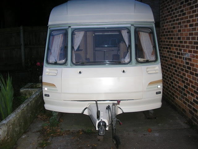

i brought it home on saturday and decided to have a look at the "small" damp patch on the rear wall around the window. simple i thought must be the seal :wink: :wink:
this is what it looked like before i started
This is how it looks now
Im sure wood should not really crumble and flake like charcoal :lol: :lol:
not only have i now got to rebuild this particular part of it but now the wallpaper will also need doing seem to recall SWMBO said something along the lines of the whole van would need to be done :x :x

Gosh Colin :shock: Not good on the caravan rot front :( Never fear though, it looks bad but it can be fixed relatively easily due to the construction methods used to build them in the first place.
It's worth doing as those Avondales are rather good 'vans.
I once rebuilt the whole front-end of a rotted out 'van. I pulled away the panel to fully expose the rotten framing and made a whole new wooden framework and made a new inner wall from facing ply and the end result was good. Admittedly that was on a non-bonded construction 'van (i.e. aluminium skin bonded to polystyrene and then bonded to ply) but the same principle holds good with yours. You have to pull it apart to expose all the rotten timber and replace it with new. Where you have exposed rot in the bonded construction areas, let in mew wood, clean up the polystyrene and rebond new facing ply to it. There is a special glue available to do this, designed for repairing delaminiating caravan floors which are usually a bonded sandwich of ply and polystyrene. Most DIY glues (such as Evostik) will melt the polystyrene. Treat the plastic front like non-bonded construction.
Fundamentally, caravan construction is pretty straightforward once you get into it. Repairs though seem to make it look a lot worse before it starts to look better.
A refinish with heavy duty wallpaper like the vinyl faced stuff for kitchens and bathrooms will finish it off a treat. Use some good paste though and not the normal household stuff; there is some stuff available that is waterproff and sticks like the old proverbial; the name of it escapes ne at the moment.
One word of caution, just like rust in metal, the rot may have spread further that you think. It's important to replace all rotten stuff and search it out and keep on letting in new wood until all trace of the rotten stuff is gone.
The end result will be extremely satisfying :D
Then you have to make sure it cannot happen again by renewing all the mastic sealing the panels together. The panel joins are usually under rubbing strips and the two long awning rails. Pull 'em all off, get all the old mastic off and replace with good stuff expressly designed for caravans. The stuff made by W4 is good and excellent for Xantia eastate tailgate membranes as well.
Haynes do quite a good BoL for caravans and it's worth getting a copy.

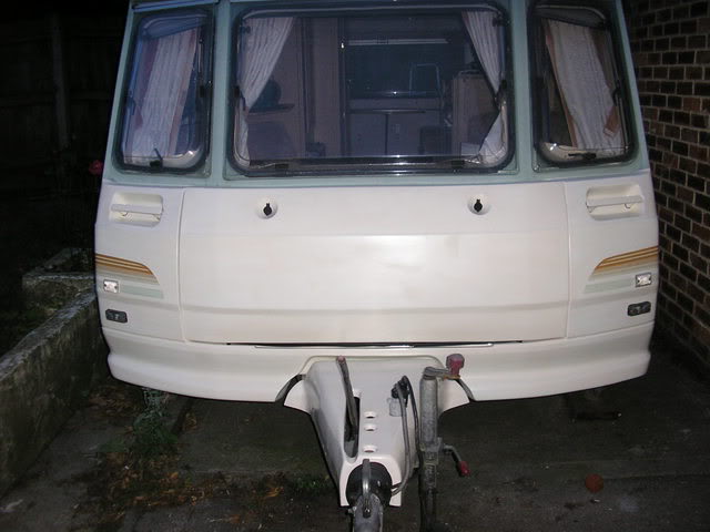

Just about finished the major rebuilding wallpapering and painting the lower front of the van plus fitting the new lid inc drilling out and fitting 2 new locks :) :)
hope it looks better in daylight :lol: :lol:
must remember to put that ladder away :oops: :oops:

A real top effort there Colin, well done 8)
Sorry to hear about the encounter with the lumps of concrete :shock: Hope the damage is indeed minimal.
It's not a bad idea at all to do the cambelt, aux belt and water pump before a big tow. You can be sure then. get the garage to carefully check the top tensioner on the aux. belt is working properly and is not seized or failing.
