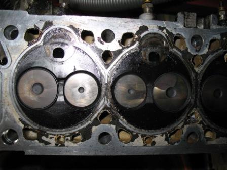

- Posts: 54840
- x 8224
This is what a head looks like just after removal and this is actually quite clean!!! They are normally much, much worse.
This was off a 1.9TD with a snapped cambelt and broken cam caps and needing a new head as a result. This is the state of the head surface where the gasket had not blown.
Still a nice clean-up job needing to be done.
As an aside, this engine had been running 100% veg for some time.
