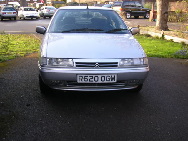

now things have been sorted and she starts as she should and i now have some heat from the blower i thought id have a go at something technical like trying to includes some pics of the new beast :lol: :lol:
thanks again for all your help in getting this far with it :D :D

Looks really great Colin :D I was just saying in another thread how the Xantia pulls off quite a trick by looking really, really good in silver. A feat no other car can quite seem to manage. Most just end up looking drab...
Yours begs a question. My Estate is an R reg one like yours but it has black bumpers and side trims. It's the only late MK1 I've seen like this as all others seem to have colour-coded bumpers and side trims. Perhaps it's because my estate is a poverty-spec one perhaps... Or is it because it's white?

citrojim wrote:
Yours begs a question. My Estate is an R reg one like yours but it has black bumpers and side trims. It's the only late MK1 I've seen like this as all others seem to have colur-coded bumpers and side trims. Perhaps it's because my estate is a poverty-spec one perhaps... Or is it because it's white?
i suppose it could have been hanging around in the dealers for a while before being registered Jim,it may not really be that late a MK1 ??
My other one is grey and is late 1996 P plate and ive never seen a grey one with colour coded bumpers and trim but i expect i must now take evasive action from all those who have seen/owned one :lol: :lol:
