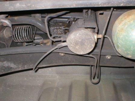

has anyone got a picture of a height adjuster with everything connected so i can do a quick 'spot the difference' exercise

Hi Peter,
This is the HC on my 2.1TD.
Note it is upside-down due to how I held the camera :lol:
If you want more shots, let me know, that one was done very quickly between dads taxi jobs...
