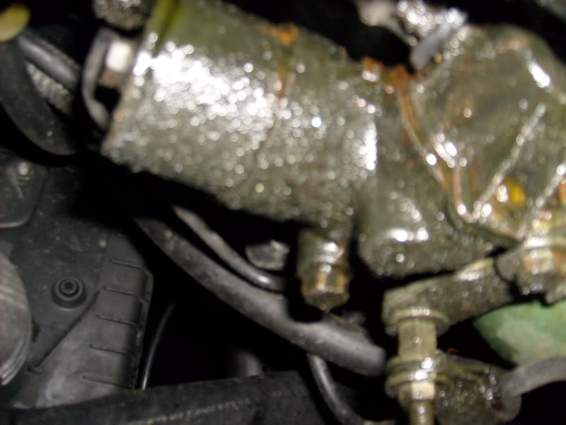

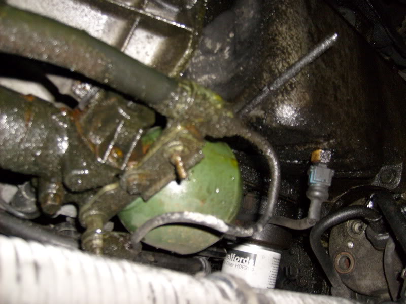

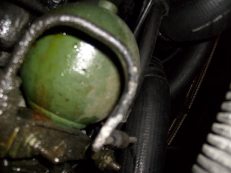

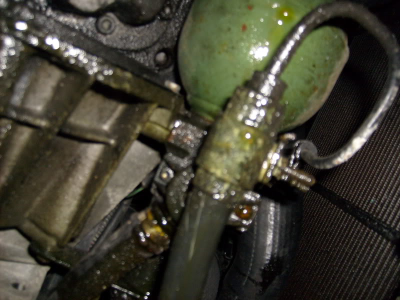

Well its only a slight leak from what I could see, managed to take some photos of the offending area - the Accumulator Sphere.

Looks pretty well soaked in LHM around there Chris.
Two things to check, either the accumulator sphere seal was not quite rightly placed when the sphere was installed and it got cut when doing up the sphere or one or more of the pipe seals have hardened over time and are weeping. More likely the latter.
Give the whole area a really good clean-up and it'll soon show what is weeping. Pipe seals will give themselves away by showing weeps on the tops of the union nuts. When I did my 1.9TD clutch I replaced a seal on one of the FDV pipes and that cured a long-term weep from there.
The plastic cup on the bottom of the pressure regulator is often a little damp and not to worry unless it is really weeping from there.

I replaced the Accumulator when I got the car which was about 3 years ago so I assume its not that.
Ive advised him to come round at the weekend so I can get it up on some ramps, give it a good clean and watch where the leak is exactly.
