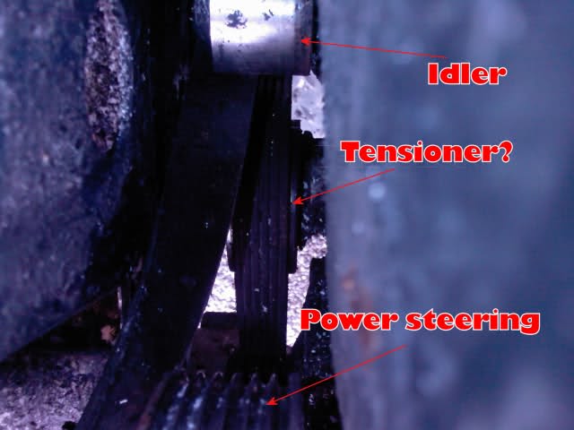

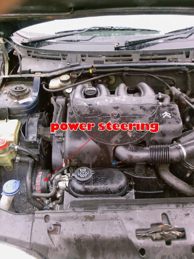

Here are a few photos of my engine which is a 1999 diesel but not a turbo and it is not fitted with AC either..

engine bay
tensioner I presume

Now my first question is this..How do I adjust the tensioner so that I can fit the new belt?
I have tried applying pressure either side of the wheel that I presume to be the tensioner wheel to no effect and I do not wish to use excessive force for fear of breaking something else whilst attempting to fit this belt.
Has anyone got a manual with a picture of the tensioner so that I can learn how it works..is it spring loaded? manual tension?

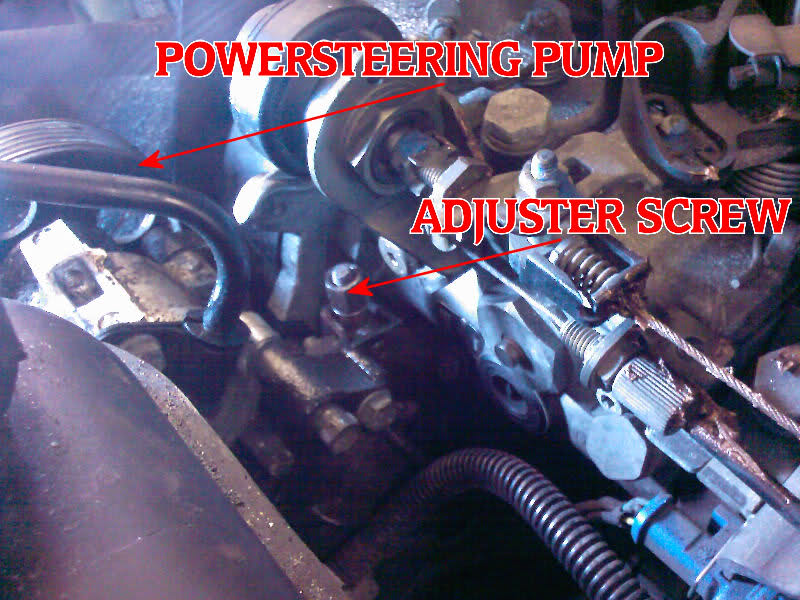

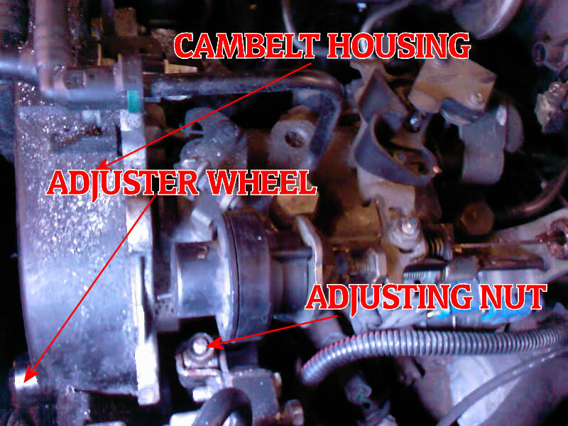

Thanks for the replies lads but I eventually sussed this problem out..The tensioner is loosened and tightened via a small bolt that is hidden under the plastic engine cover and is right begind the PSP..as per this photo
Here it is again from a different angle
If you turn this nut anti-clockwise is slackens the tensioner and vice versa to increase the tension..I hope these pics help some one out as this was a right conundrum to suss and is no way an obvious solution to this problem..
