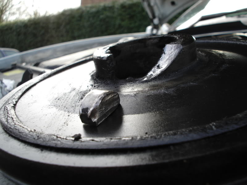

Update
Once I released the auxillary belt tension the problem was most obvious. The damper was flapping around loose as you like. The pulley bolt, however, was very tight all the way out (must be a lot of sealant dust in there or something). Jim's guess the cambelt pulley failed again was, fortunately, incorrect. Not so fortunate for the damper though.....
The broken piece was wedged in the cambelt pulley recess and the woodruff key just dropped out. Now I have to figure out how to get a spare from the breakers before the end of the day!

Agreed on woodruff key, it's well hammered. As long as I don't have to remove the cambelt covers I'm willing to give it a go releasing the cambelt tension - is that possible?. I don't have much choice really either way. Of all the weekends, for this one I need a car
Poole breakers don't have one but New Forest Auto's reckon I'm in with a good chance as they got both Xantia's and Pugs. Not sure which model pug I should look to (109?) I'll take the part with me to be sure.
