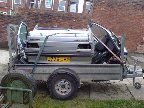

I recently scrapped a 405 saloon,i jacked up the back of the car and undid the fuel filler pipe at the highest jubilee clip,the pipe will bend down enough to allow the diesel to flow into a can (via a funnel) As you get less and less fuel in the tank undo the bottom clip to allow you to twist the pipe round to get even more diesel out.
Then under the bonnet,use the hand pump thingy to pump any remaining diesel out via the drain pipe on the bottom of the fuel filter.
When i eventually cut the car up to fit into my trailer,i removed the tank to get the very last bit out cos im daft like that!
Have fun :D

How did you cut up the 405, have you got a Holmatro at home ?
matt
Posts: 139
Joined: 09 Mar 2005, 03:34
Unread post by matt »
ACTIVE8 wrote:Hi matt.
Ha Ha! No,just a trusty old Stihl saw!!
