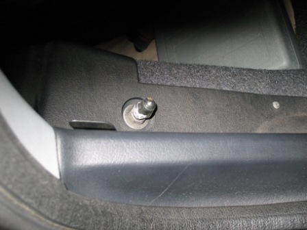

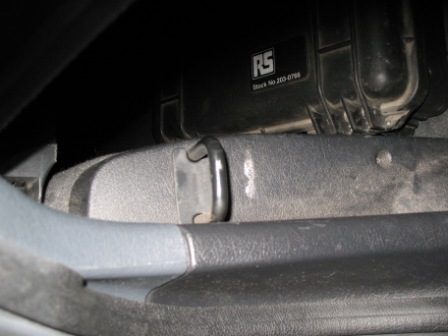

Jim I dont suppose if you have a sec sometime this week, could you take a snap of the C pillar area, with the seat back forward?
J
Posts: 54556
x 8063
jgra1 wrote::twisted:
J
Be happy to John. I'll do that tomorrow in daylight.

John,
Pictures:
Hatch "C" Pillar. The squab anchors on a spike. This in a MK2 but MK1 is the same..
MK1 Estate "C" Pillar. The squab anchors onto a hoop which is higher up the squab than the spike on the hatch.
If you want any more views John, just let me know...

Jim many thanks..
hmmm....
