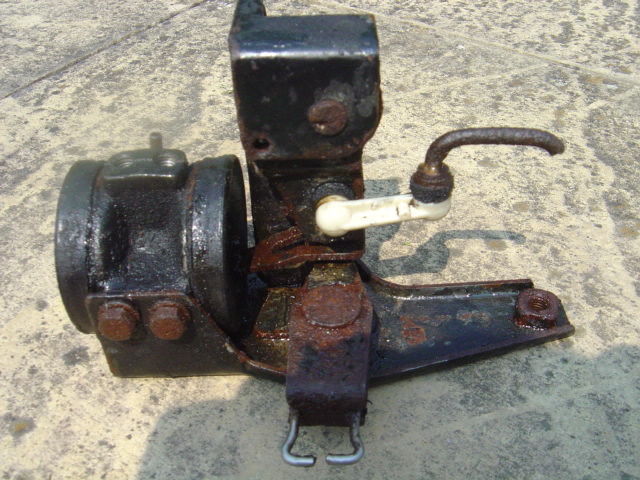

The rear height corrector is a bugger for doing this, the problem is that it all sits in the middle position for years, then you pop it on high and it wants to stay there, best possible cure is a new or recon height corrector.
Sometimes but not very often, a lot of WD40 and exercising the linkage will free it up, but putting a new plastic link on with a siezed cradle will only end up snapping the metal anti roll bar link, see pic.
Getting to the original problem of the front end, you could try the adjustment, but they dont realy go out of adjustment without someone playing with them, you may well find that you are in for a pair of height correctors.
