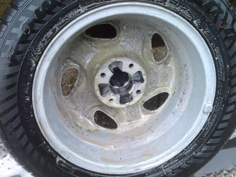

First of all i acid clean the wheels, the front wasnt a problem but the rear of the wheels were really bad! A mixture of caked on brake dust and corrosion the worst of which i've ever seen was attacked with the acid which is about 20-30% hydrochloric, the picture below shows the acid at work after the 5th clean!

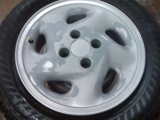

The next picture shows the wheel after all the marks on the face were removed with a mini D/A sander, kerb damage of which there was very little was smoothed out, and the corrosion on the face in the spoke area was also done in the same way, i had to do some bits by hand.

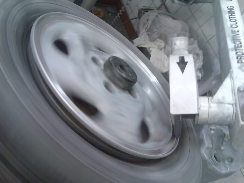

The rim edge was done on a special machine, it removed all the paint from the edge to bare ally and also the corrosion. I could have gone further and left it with a polished edge but didnt want anything too fancy and the finish can detoriate after a while.

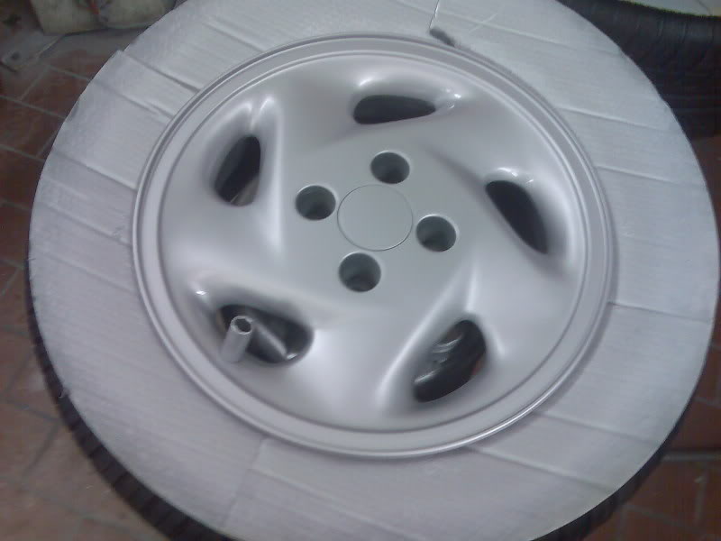

This picture shows the wheel after it was full prepped and cleaned again, and it had three coats of a bright wheel silver.

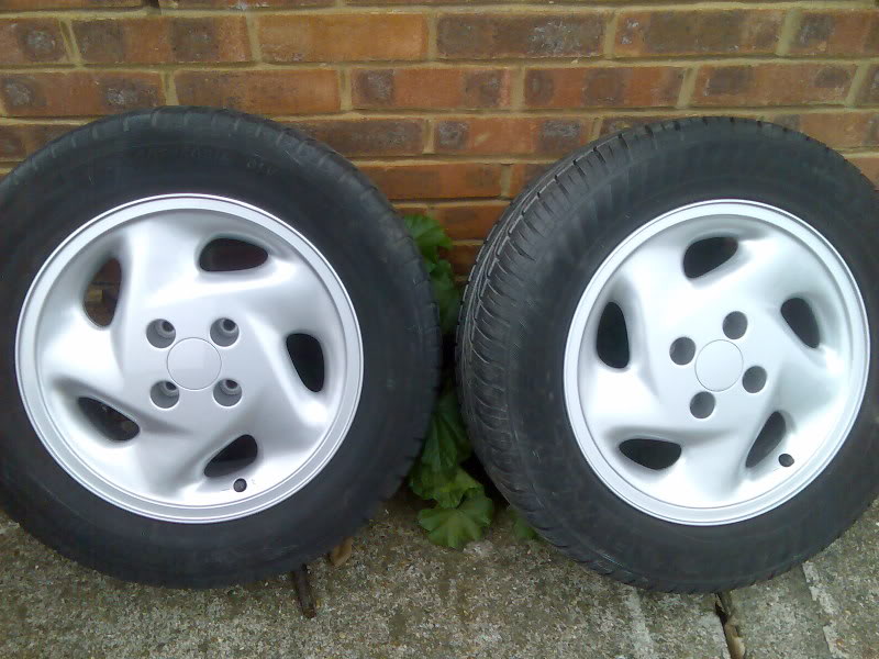

And the end result after 2 coats of 2k Laquer.
Two wheels done, two to go!

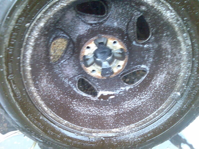

Some more pictures, bloew shows a wheel just before it was cleaned, i managed to get it back to clean metal where it had corroded because of the brake dust and road dirt.
The wheel machine in action

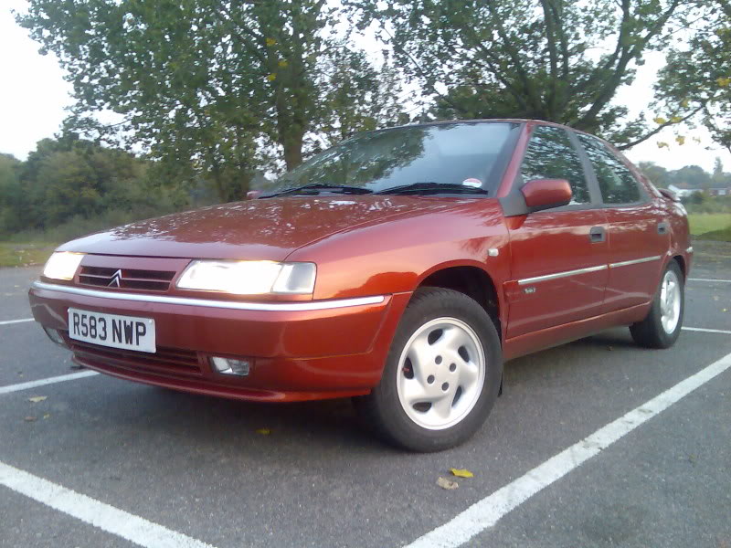

Nice job well done, have there been any issues with clearance on the front wheel arch's?
25 Jeep Renegade Trailhawk
23 BMW iX3 M Sport Pro
23 Jeep Avenger
13 Ram 1500 Hemi
06 C3 Desire 1.4
72 DS 21 EFi Pallas BVH
XantiaMan
Posts: 1604
Joined: 12 Aug 2007, 18:47
x 18
Unread post by XantiaMan »
DickieG wrote:Nice job well done, have there been any issues with clearance on the front wheel arch's?
Only driven round the block so far but in normal running there is plenty of clearance, even when suspension is dropped it clears the arches ok, but does look beefy on the front!
