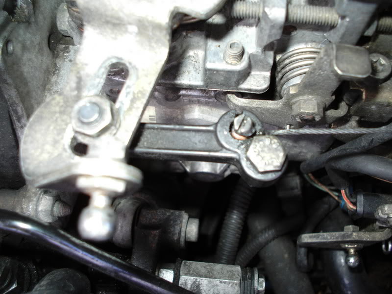

Went to GSF this morning (after the cable broke again just before going through the dartford tunnel) and got the kit. However the fitting i need to go at the pump end is wrong, would anyone be able to donate the linkage that is attached to the pump end for me? i've clamped it with a bolt for the time being but im not happy with the arrangement. Also a pic of the original arrangement would be good.

What pump do you have? Bosch or the other one?
Also you will find it easier going from the pedal end to the pump, when mine snapped just out side my house after a 500 mile round trip, i left all the tubing in place and just replaced the cable, its been fine ever since.
If you have a Bosch pump i can get you a picture of my fittings for you?

It's a Bosch pump.
I've seen a small pic in the haynes manual, looks like the original fitting at the end of the inner cable had a nipple on the end of it, which then slotted into the plastic bit of the linkage. The bit i have has a grub screw which would require a nice clean cut of the cable (i dont have any decent cutters) and i do trust the grub screw method as it only lasted about an hour.. May just drill a bolt, 2 nuts underneath and two flat washers to squash the cable - job done!
