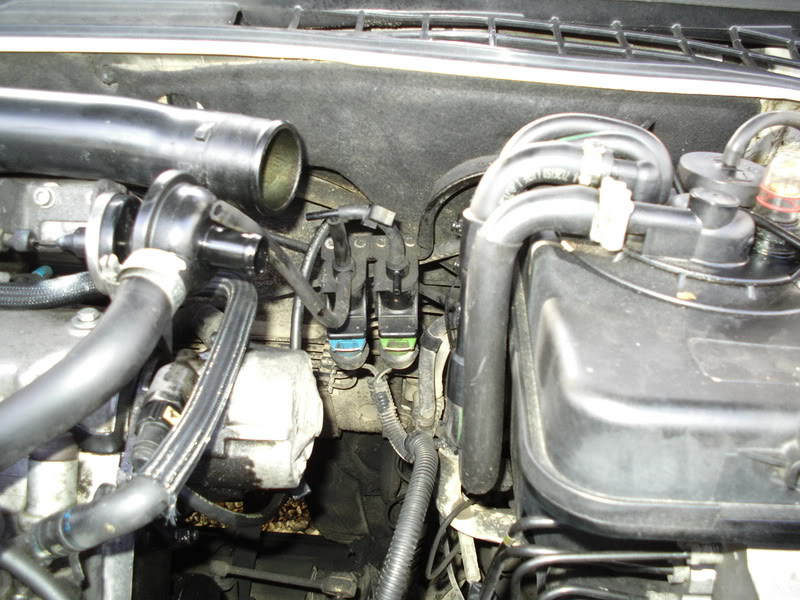

There are two electrovalves (on mine) side by side fitted to (or bracketed on to, can't recall now) the bulkhead between the LHM tank and the engine. A vacuum pipe comes from the vacuum pump situated on the end of the crankshaft. That pipe goes down to the electrovalves into a t-piece to feed both.

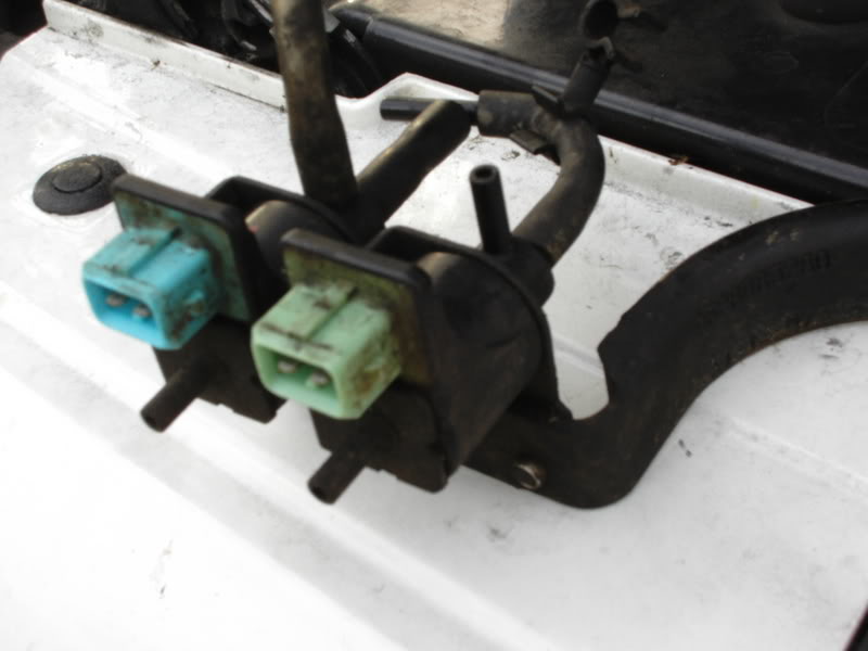

Well I decided to have another look at my fast idle system today and after removing the airbox and first induction pipe, you can clearly see where the the two electrovalves are located.
But I then discovered a third in/outlet underneath each valve which in the default state, passes atmospheric air through to the device it's attached to (fast-idle or EGR).
Is this proper? I'm guessing it's to release the vacuum once the electrovalve is de-activated and is blocked off when activated? I haven't been able to test this yet and if the electrovalve has failed I won't be able to anyway.
