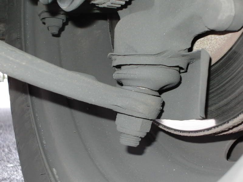

What balljoint are you changing Mike, a steering track-rod end or the lower swivel?
I ask as the former is easy but the latter can be a

I'll take a pic of the loose joint for recognition but it's the one fixed to the short strong arm that comes off the base of the wheel if I remember correctly.

When I had the wheel off the ground, holding it at quarter to three and rocking it, there was freeplay at this bush...
It's not the only job that needs doing but this one is probably the reason for my steering/handling problems and maybe why I'm seeing premature tyre wear around the inner circumference of both front wheels?

That's your lower swivel joint Mike and they can be a bit of fun. Not to be tackled without the tools and facilities. The last one I did it fair made me sweat
It may well accoun t for all your handling/tyre wear problems. Luckily, new ones are cheap.
As I say, I'm very happy to help you with this but it'll have to be at mine, as much as I'd love a trip to Christchurch as I need my huge blacksmiths vice and other non-portable items in my garage to do the job!
