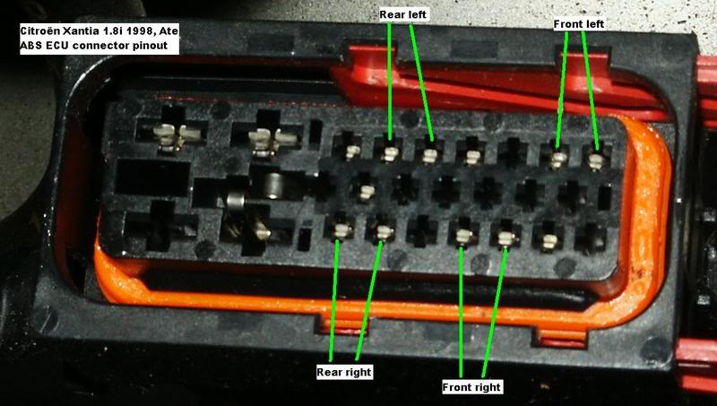

Does anyone know which pins in the the connector the othe ABS ECU correspond with which wheel sensors on a 1998 series 2 Xantia?
I have the list for the series 1 but the series 2 has a different plug. I can't see any pin numbers on the plug either so the a clue as to which way they are numbered would be a great help as well.

Something I found on my travels :D :D :
Andrew

You are an absolute star - whatever did we do before the internet?
Many thanks
