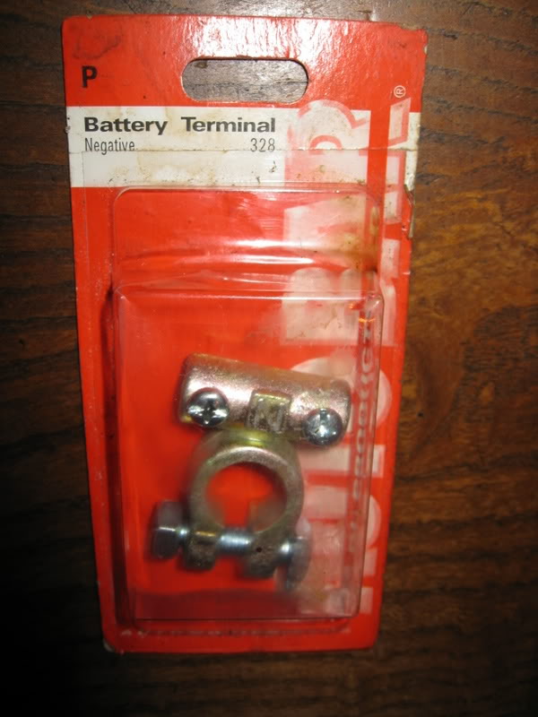

You'll need one of these:
(I realise it's a -ve one but the +ve is the same only slightly bigger)
purchased from Halfords and the like. That is, if you have alternative
means of getting there!! It's better material and innexpensive at about 3-4quid.
I'd try and break the old terminal remains off the main feed cabling and
you'll fit a new connection more easily. The original is lead so will be very
short and malleable which is why it broke in the first place...
It's a very thick series of cabling which will be potentially difficult to
combine into an after market connector so you may need to at least
remove one wire and fit it on via a crimped ring connector instead.
Andrew

When my negative terminal went I used one of those after market jobbies in the picture but I managed to solder it on, a bit tricky mind, but probably better than relying on the screws.

The one in that pic appears to be passivate plated steel - i'd prefer a brass one if there was a choice, but one of those is better than a broken one! The screw method isn't ideal as it tends to make a mess of a bared cable - hence the copper pipe suggestion above (forgot to mention - polish the pipe with wire wool to remove any laquer first...).
I'd go for a ring terminal version only if I had access to a hydraulic crimper - from memory, those "generic" ones are also available with ring terminal fittings (wing nut?). Could the remains of the old connector be drilled to fit on one of those?

The replacement terminal with the 2 screw fitting looks a bit crude but from my experience seems to do its job very well form many years judging by some of those I've seen. If you're into large in car audio you can even get gold plated ones. Soldering is the nice way to fit them but using the screws seems perfectly satisfactory if not very elegant. If there is room bending the bare wire back on itself when fitting it will give a better connection.
