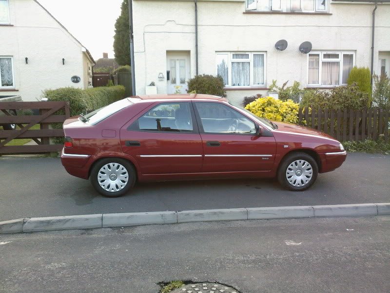

I have a 1997 Xantia 1.9 TD LX, its a lovely car, and seems to ride very well, and handle as you would expect a Xantia would. However, i need to know if its suspension behaviour is normal.
When you turn the engine off, and get out the car, the car rises at the back (reduced weight) then drops back down, lower than i would expect.
With the engine running if you put your weight on the back, it will respond to this in a few seconds and rise up to compensate.
As i understand it, my car has an anti-sink which should stop it sinking with the engine off, but it always looks too low to me?
When started from cold it takes about 5 seconds for the stop lights to go out, when started during the day, less time.
Any ideas? Below is a picture with engine off.

It sounds about normal to me. With a good accumulator sphere it should rise up when you sit in the back even with the engine off.
When the anti-sink sphere is flat the car doesn't sink when you park it, it sinks when you start the engine again.

I have a similar situation with my 2.1TD, I turn the engine off, get out, it pops up then sinks way down.
Suspension is firm like a normally sprung car, but not flat sphere firm, and all spheres were changed back in April.
My 1.9TD on the other hand stays up when I get out, has a much softer ride too.

Reallly? So why does it sink down in the first place? I thought if the anti-sink is there to stop it sinking when parked, so as not to be like the older citroens... that sink overnight?reblack68 wrote:When the anti-sink sphere is flat the car doesn't sink when you park it, it sinks when you start the engine again.
If it sinks when parked, what does this indicate? I have the same problem on my V6 and I have suspected the anti-sink sphere. Now you have confused me.
I just went out and measured the the heights roughly, 400mm when engine off at the rear, 430mm with engine running but unladen, at the front it was 170m with the engine running (taken from the base of the subframe) I think that sounds about right.

That's what I used to think, but people "in the know" here said that the acc sphere keeps the car up when the engine is off, and the A/S just covers the drop in pressure when the engine starts before it re-instates the pressure after a few hundred revolutions of the pump.deian wrote:Reallly? So why does it sink down in the first place? I thought if the anti-sink is there to stop it sinking when parked, so as not to be like the older citroens... that sink overnight?reblack68 wrote:When the anti-sink sphere is flat the car doesn't sink when you park it, it sinks when you start the engine again.

I think it's a non return valve that keeps the back end up. When you start again the valve opens and the back would sink if there wasn't stored pressure in the anti-sink sphere.
A Xantia should rise when you get out and then sink back down to compensate. They do seem to sit a little lower when parked than when they are running.

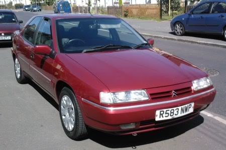

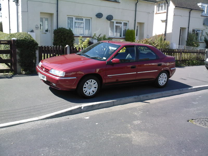

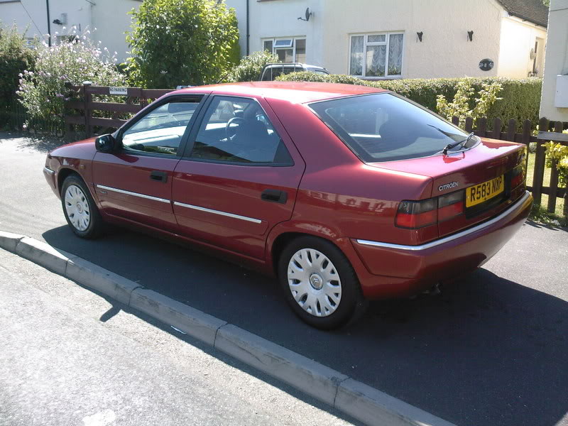

Here are some more pictures.

Rear height looks perfectly ok to me, especially in that last picture - its normal for the guard to be about in line with the top of the tyre at the rear.XantiaMan583 wrote:Here are some more pictures.
When you get out of the car the rear will rise a long way due to the weight change and the fact that the rear suspension is (supposed to be) so soft.
If you watch it correct downwards after you get out it will seem like its going an awful long way, but thats normal...
If you're really paranoid about it and want to do an accurate measurement, have a look at:
http://homepages.igrin.co.nz/simon/imag ... ia_height/
If the rear height corrector linkage is a bit rusted/seized, it may cause the height correction to overshoot or undershoot - measure the height after both an upwards and a downwards correction and compare them - ideally they should be within about 10mm of each other. If there is a large difference of say 30mm I'd give the linkage a good spray and grease to try and free it up a bit.
By the way the calculated rear height for mine to the subframe with my 205/60/R15 tyres works out to about 436mm, so 430 doesn't sound too far wrong.
If the ride and handling seems fine and it achieves the same height fairly accurately each time, I would leave the height alone.
