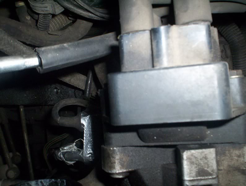

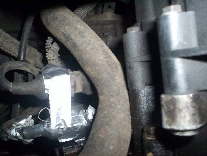

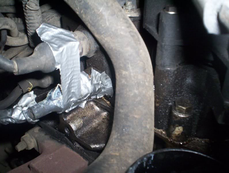

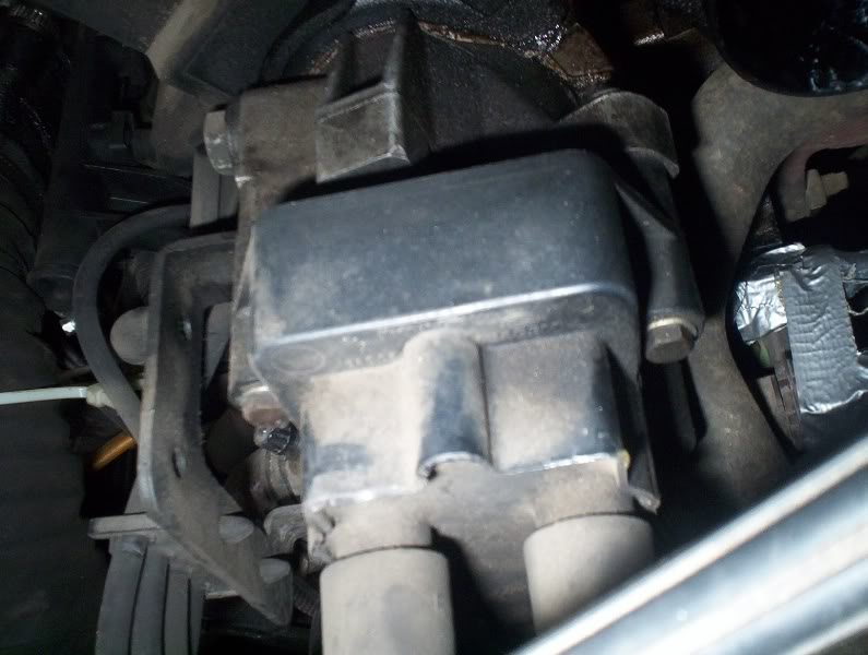

OK, here are the pictures. I accidentally broke one while trying to remove the speedo connector from above. The plastic was very brittle.
You can see the coil pack and the connectors in the bottom
Here they are a little closer
Closer
Here is another angle for reference

philhoward
Unread post by philhoward »
My money is on the temperature sensors...
Clogzz
Posts: 2125
Joined: 15 May 2005, 18:04
x 40
Unread post by Clogzz »
They look like high-tension wires of the sort going to the plugs.
Perhaps something to do with 2 firings per stroke … afterburn.
Temperature sensors normally would have thin wires.
2002 C5 2.0i AL4 240,000 km 76372389
oscarloco
Posts: 369
Joined: 24 Nov 2003, 23:02
x 2
Unread post by oscarloco »
Clogzz wrote:They look like high-tension wires of the sort going to the plugs.
That's it! They do have thin wires. But they look much bigger because of the insulation.
The one thas is broken came loose 2 days ago, check light on and the engine became very very rough. That explains it.
Thank you guys!
