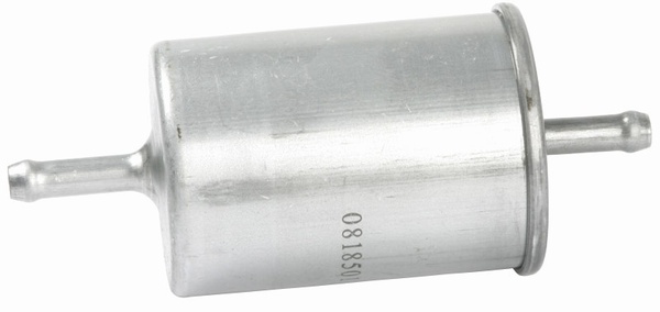

I believe that many owners aware of the HDI pump problems simply fitted an extra filter same kind into the fuel line from the tank pump.
You may fit it in an easy to reach location in the engine bay.
Thats about the cheapest insurance you can buy yourself.
Note : do not use the old & cheap type carb filters, which can not withstand the lift pump pressure. Any inline alucan petrol injection engine fuel filter will do. They are used in most PSA petrol injection cars. Cost some £10.

Thanks Anders. Do you know what sort of pressure the lift pump operates at? Will try to fit another filter in the fuel line at the back of the engine where there is some spare room. Not much room under the top cover for anything.

Dont worry on the pressure. Thats just the lift pressure which I presume is in the order of approx 0.8bar, as this is the working pressure for petrol lift pumps in general.
The filter type I mentioned, is the standard Citroen (PSA) petrol injection filter. Approx 2.5" dia by 3.5" lenght, with 6mm studs each end. Its also used in multipoint petrol engine systems, which runs off a 3bar lift pump pressure.
It will therefore readily withstand your HDI low pressure side fuel system pressure.

Honestly guys -
With the pricetag on a HP pump repair, whats the reason to discuss if the fuel inlet pressure would drop another 0.1-0.2 bar - even less ?
Go on and fit that filter shown (its a large filter with known large throughput). I really cant think of a cheaper insurance.
The filter should be fitted inline on the fuel line from tank to first filter - to be sure you dont introduce new swarf alone by the fitting job.
Like deejay suggests.
Anders (DK) - '90 BX16Image
