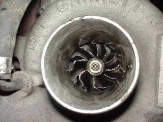

You are DEAD sure you want to remove the turbo ?
I wish I wasnt sure but as you can see the inlet side of the turbo is, to put it mildly, goosed! And without a new turbo all my car is good for is emptying the sump of oil and sticking it in the the intercooler as well making big clouds of smoke behind it.
Ive done all the other jobs that need to be done as a result of the turbo being broke. Including finding the right turbo (wasnt easy or cheap) I just have the turbo left to change and typically its a pain by not being straight forward and typically peugeot.
Changing the turbo on my own will be the hardest job i have done on a car on my own hence the questions. I want to get it right first time.

Ohhh that one :oops:
