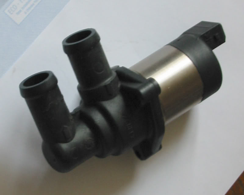

Hi - try looking at this:
As Phil said it's the most likely culprit. When my Xm used to have a similar
problem, it used to run properly again when it got a good firm clout from a
screwdriver handle..
Eventually got fed up and changed it and never had the problem back!
Effectively it's like a Stromberg carb single needle "jet" that can stick preventing
the air into the inlet circuit. If it's present on the car in question it'll be
found near the battery box!
Andrew
