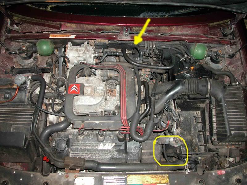

i have a big problem, the main supply pipe from my hydraulic pump down to the flow divider at the front burst on my 24v XM on Friday night.
When i last ordered one of these for my last black V6 it took 3 weeks to come from France, and i need this one urgently as my other car is off the road for maintenance work at the moment aswell.
its this pipe here (marked by the arrow) and leads down to inside the yellow circle at the bottom of the engine bay.
The pipe had burst just about the flow divider at the bottom of the engine bay, the other night when i started it to see the leak, it was blowing it right up to the height of the front rocker cover.
So far all i can think of doing is loading it onto dads trailer and taking it with his Discovery to a couple of the citroen specialists in Glasgow and seeing if anyone can cut it and remake the end on the pipe.
Any other suggestions??

http://www.citroen-hydraulics.com/
They may be able to help and send one by post.
