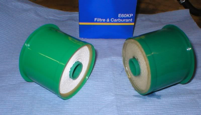

For a while now I have been trying to understand why I've been experiencing starting difficulties after an overnight stop on the 205D.
I am posting this in the Citroen part of forum as the Xantia uses the same type of filter, as do many Pugs.
All the symptoms I had pointed to air in the fuel lines.

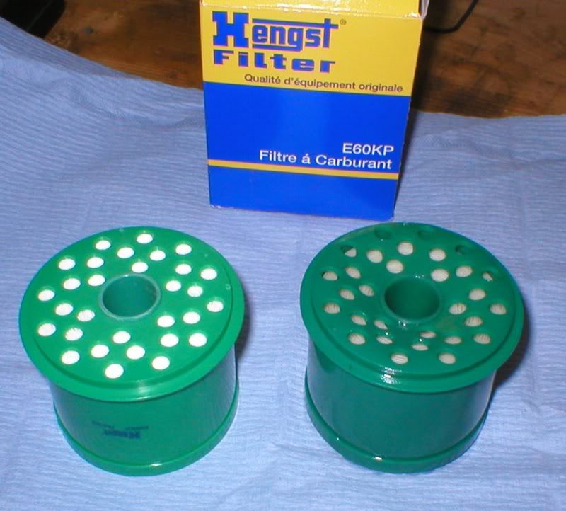

Here, in the end, was the cause. A pattern Hengst fuel filter. It was pushing up the lid of the fuel filter and admitting air.
The pictures show a new one and the old one on the right. The old one was very difficult to remove from the housing as it had swollen out of shape and the filter element had spilled out of the bottom. A disctinct bow can be seen in the top of the filter. The discolouration and distortion of the plastic suggests the body is made of something that is not very diesel resistant.
I have posted large pictures to make the swelling and distortion clear.
I just hope the swelling has not fractured the filter housing :evil:
This particucular one was bought from ECP about four months ago and has seen no more than about 900 miles use as the car is very lightly used.
So, if you have one of these in your car get it replaced very rapidly. If you are offered one refuse it! The brand-new example I still have will be thrown away pronto.
It has now been replaced by a traditional metal type.
I'm worried now as all my fleet have Hengst oil filters fitted. They are going to be changed tomorrow.
Any one else seen anything like this?

I'm rather worried about the fact that the glue from the bottom looks like it's about to be "let loose"...I've only ever used Purflux and don't intend using anything else.

philhoward wrote:I'm rather worried about the fact that the glue from the bottom looks like it's about to be "let loose"...
Quite. In fact it HAD let loose and had gone distinctly soft like RTV silicone.

There is a fair risc that you have got a cheap far-east (illegal) copy product not holding the specs.
Anders (DK) - '90 BX16Image

Looks like a bootleg one even from this distance. :!:
You would expect Hengst to be able to write in French.
Fuel filter is ‘Filtre à carburant’, not ‘Filtre á carburant’.
Actually, ‘á’ doesn’t exist in French, but the bootleggers don’t know that.
In this context, it’s also ‘Qualité d’équipement original’, not ‘originale’,
because the original refers to the equipment, which is male in French,
while the quality is female. :wink:
You should be able to take the lot back, but the supplier has probably been had too. :shock:
