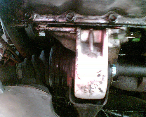

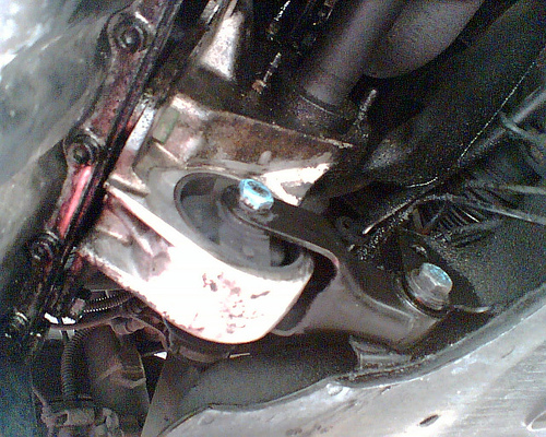

Hi guys, (car is described below)
I decided to check my bottom engine mount today because coming on or off the accelerator you can feel a slight movement. OTher symptoms are slight vibrations under load going up hill and sometimes around corners, anyway...
I went under today and had a play with the mount with a big screwdriver it does seem soft and there is a bit of play, you can even see gaps where it was pressed into the brakcet (bigger side now), so can I be quite sure this is the problem?
Next... it seems like i need to take a driveshaft/s out, this bracked is attatched to a channel where the drivers side driveshaft connects to a connecting driveshaft coming from the gearbox. This worries me as it now seems like a big job! Can anyone confirm to me that I will need to buy one big unit, and not just the bracket, I guess the bush is pressed in at the factory and the unit is sold as one big part where the driveshaft have to come out.
See pictures here.... Better to go to the links as the notes help a lot!

I could be wrong but I thought you could just get the bush?
deian
Posts: 1729
Joined: 26 Feb 2006, 10:53
Unread post by deian »
Well this is what i'm hoping!!
But my cousin was with me so i could have a second opinion and he reckons you need the whole braket, although he wasn't entirely sure.

Yep the bush is available as single part - some $7. Its the same for all PSA XU engines.

I replaced one on a BX and did not have to take the driveshaft out.
It seems to be the same set up on the Xantia.
As Anders said, you can buy just the bush in it's steel tube.
If you saw through the steel tube, the old one will pop out easily but you will have to work out some form of simple bolt puller to draw the new one in. If you put the new one in the freezer for a few hours before doing the job it will make it easier to fit.
