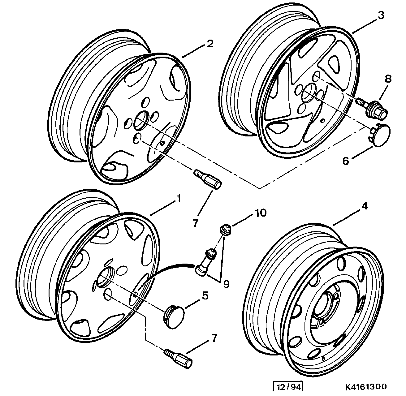

Rightho, been snooping about Citroen's parts listing - the Xantia turbo alloys ARE definitely different from EVERY other wheel bolt on a Xantia so you'll need the right one for the wheels you've got [OK there are later Exclusive alloys which use the same type but that's not directly related to your situation here].
The shoulder isn't the usual 60 degree taper type of the steel bolts [and I'm wrong to say the alloy is a different size etc - I'm thinking of Xm's!!]. Shows what I know about my Xantias!!
The type you'll need is a 'normal' type bolt head with a flat shoulder with a large shoulder:
Seen these type on Pugs too, so there'll be plenty to choose from in the breakers etc...
Andrew
