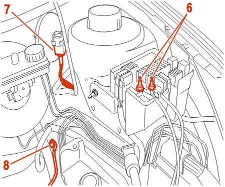

under the bonnet prob on the bulkhead or strut towers, its a rubber toped push switch, the ruber cover is either black or red
rossnunn
Posts: 1254
Joined: 09 Aug 2003, 03:00
Location: Boston, Lincs
My Cars:
Contact:
Post by rossnunn »
Looks like no 7 in this pic

No sign of an inertia switch in any obvious place.
where is the imobilisor relay? the only relay I can see under the bonnet is a large one next to the fuse box. it has numerous wires going in to it including one direct from the battery. I thought this was for the glow plugs.
