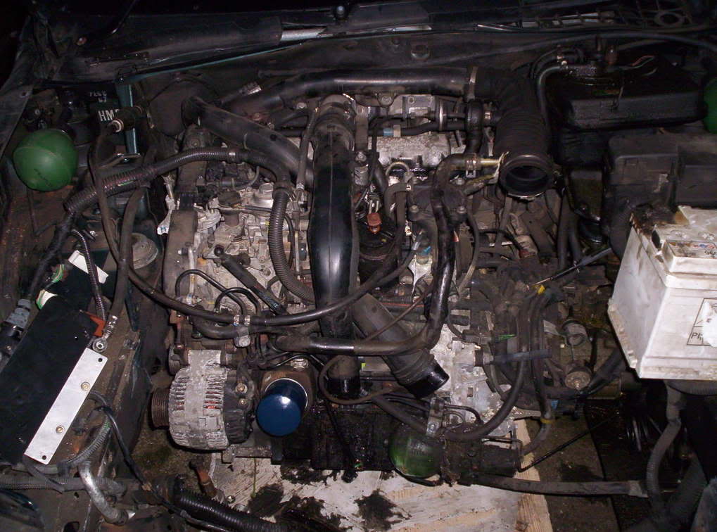

I have bought a '96 xantia td lx to use the engine in my vw campervan no laughing
I had fully intended to take off the diesel pump and it's ecu and replace with an all mechanical pump for my transplant but the ecu seems to only control very minimal stuff on the pump.
My question is how easy is it to isolate the ecu from the rest of the car and keep it with the engine, like does the ecu wiring go all over the dash or is it local to the engine only, because it seems to be an afterthought when the car was built.

Dont think a '96 Xantia TD has ECU controlled diesel engine ?
It might simply be the alarm/lock system residing on top of pump that confuses you ?
Anyway - its certainly no problem fitting an earlier roto-pump instead - with all the wellknown mecahnical bits & coldstarts etc.
Why laughing ? - The PSA XUD type diesel lump is generally known to be reliable and easy to service. Its found in all later diesel Citroens & Peugeots and lots of other makes with diesels - as OEM delivered engine.
Spare parts available all over the world.

I didn't think so either but definitely got an ecu in a plastic box next to expansion bottle and has a load lever sensor on pump which would tend to suggest a bosch as3 pump.AndersDK wrote:Dont think a '96 Xantia TD has ECU controlled diesel engine ?
please let me know if I'm not supposed to post pics due to this sites bandwidth
laughing because I'm gonna throw the engine in a '71 vw campervan and I have no previous citroen experience, steep learning curve whilst I'm stripping the car of parts I don't need to get to parts I do.

The Hains book list ECU models as from'97, but I suppose it depends when in '96 it was registered. The AS3 pump is referred to as semi electronic so presumably must have some sort of ECU. If its connected directly to the engine i.e. not through the main loom, it shouldnt be to difficult to incorporate it in your new istallation but as Anders says, its not difficult to change the pumps over and their should be plenty of secondhand ones about.
I wish you success with your conversion. I used to do conversions with Perkins engines many years ago before you could buy a decent diesel car, but they were relatively simple then, all rear wheel drive.
yes I think I'll stick to plan 'a' and swap pumps.

Hello,
I've done just as you say.
I've taken off my ECU controlled Bosch AS3 pump and replaced it with an older Bosch pump which doesn't have the imobiliser or solenoid timing advance.
The ECU on the 1.9 turboD engine in your picture gathers information and the outcome is to control a solenoid on the base of the pump which controls pump timing.
My AS3 ECU pump didn't seem right so I purchased an older pump off ebay and have just fitted it. The older pump has a timing advance mechanism which works off pressure from the pump's internal vain feed pump. It works ok. Better than my AS3 pump.
I detailed the work in this post :-
http://www.frenchcarforum.co.uk/forum/v ... hp?t=17476[/url]
