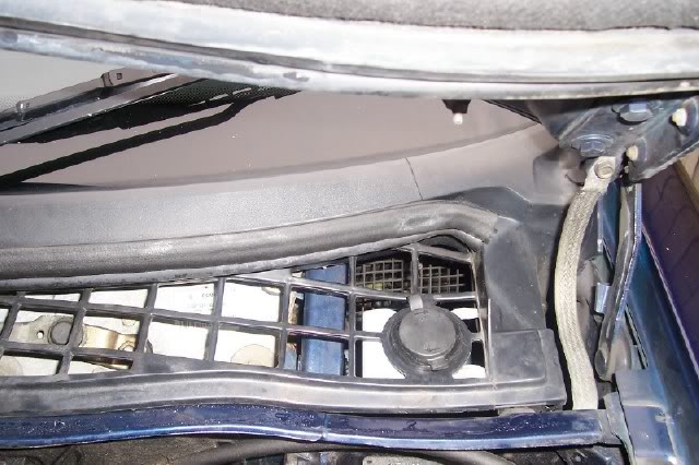

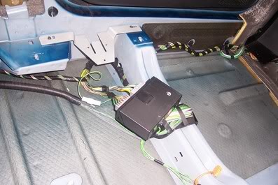

Here are some pics. Courtesy of Photobucket.com.
Crack in Scuttle plate trim beneath windscreen but over heater air intake. It's such a neat crack I thought it was a join in the plastic !
Carpets out. Alarm unit under seat. I think it should be attached to the white bracket sticking out from the side of the footwell. It is now anyway. A self tapper right through the top plastic.
